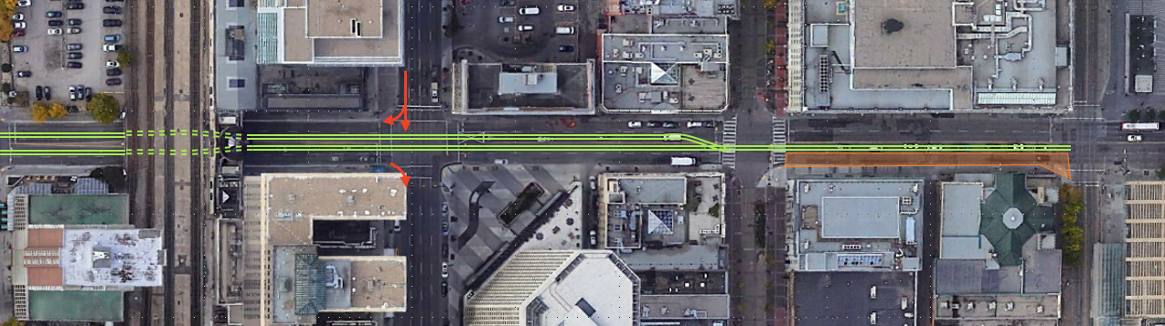

You don't need anything that complicated; here's 1st St (north is to the right):
1st St becomes transit/ped only (with bikes if room, but I'm not sure there would be) between 9th Ave and 7th Ave. Bus stops between 8th and 9th aves, both sides available for loading and time points. Through buses can pass along the tracks. Between 7th and 8th aves, the west lanes are through bus - one southbound and one northbound. The east center lane is the stub tracks at a station, and the eastmost lane is used to expand the pedestrian realm to handle the station and associated fixtures. The only slightly weird thing is when northbound buses meet a reversing southbound train, but they could put a signal to stop buses back of the switch; if professional transit drivers are the only users I'm not too worried.
The same thing could be done for a north leg of the green line, on the other side of 7th Ave; the train would come down the Centre Street Bridge, go one block east on 3rd ave (where there would be a Chinatown station), and then do the mirror of this setup, with buses stopping between 5th and 6th Ave (which could also maintain access to the Suncor parkade). Anyone wanting to go NC-SE would have to basically just cross the street, which would be a small hassle, but would avoid the problems associated with LRT lines crossing. The lines could be joined up as part of the work when an 8th Ave subway is built.

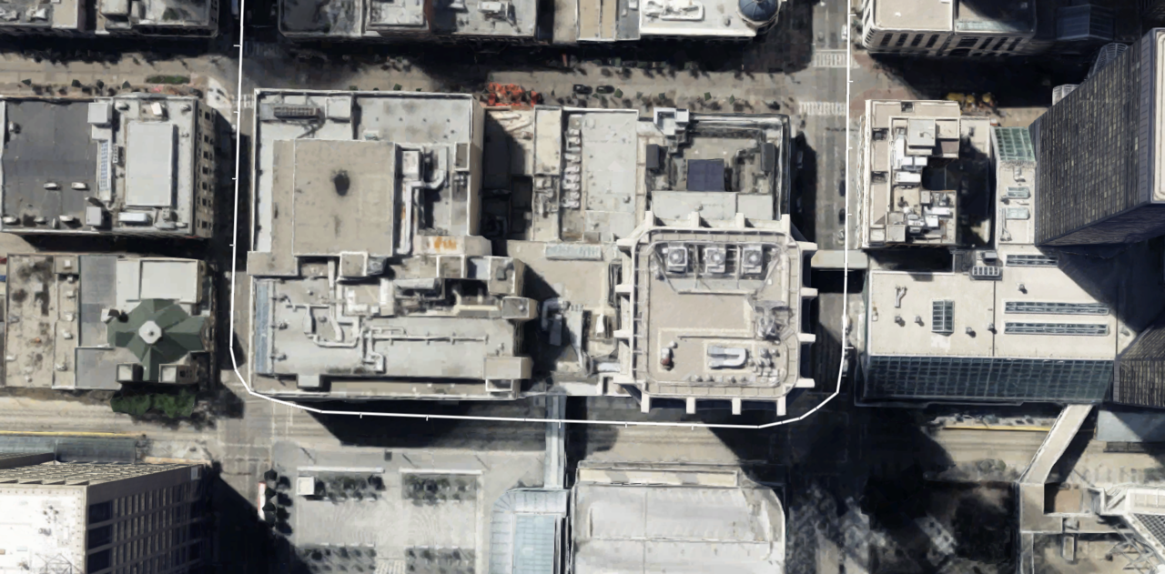

Isn't the issue with this otherwise great idea that the trains are too long to fit on a single block? Operating 2-car trains means a length of 84 metres, too long for one block. i don't see them going down to 1-car trains. Cutting off Stephen Ave isn't an option I want explored either.
Where this could work?
Macleod Trail, with an extended ROW on the east side of Macleod under the CPKC tracks? In the way is an Enmax building at the substation south of the tracks and a non descript one story building north of the tracks. The block is long enough to accommodate the 2-car train. One not so minor issue with this... you're still dumping passengers at City Hall Station.
Isn't 84 metres exactly the maximum size though, and why this vehicle length was chosen, given the future plans to run on Centre St N where the stops will be on short blocks between avenues?
IIRC originally the underground stations were going to be ~120m, to approach similar capacity as the existing 125m planned max for the red line. Over time, part of the value engineering was cutting the stations down to two car trains.
I get just under 84 metres for that block. So it is possible.
I still don't see them dead-ending the line at 7th Ave, even though it would only be a short transfer to take the dead-ended north section on the other side of 7th.
