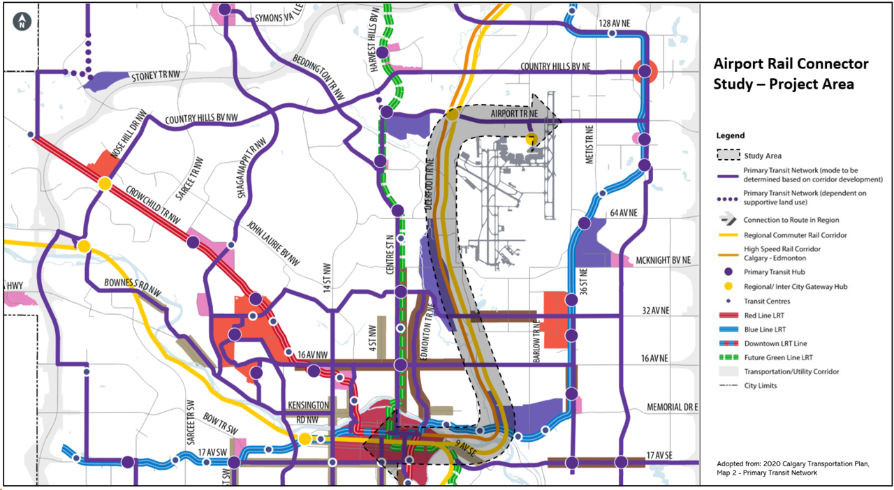

A part of the ongoing airport access study is about planning for something akin to a basket weave in Inglewood, which is where lowest minimum cost for airport access only (likely one track) would potentially lock in constrained capacity which would squeeze any other future service.
Trying to understand how a basket-weave for rail in Inglewood would even work.
This is what the project area for the Airport Rail Connector study looks like.
Will be interesting to see what it comes up with.

Meaning it switches across the 4-5 tracks in that span and no other trains can really be using that space at that time? Or grade separation?
I see the single track constraint across the Bow (and then Fox Hollow to Beddington where it wouldn't be very difficult to twin), and then from 14th Street west (plenty of spots to at least add sidings). Negotiating the north constraint seems fairly simple, but doesn't a station to south of the tracks make things way more complicated? Constraining it to the point where a 'grand central station' is completely unnecessary?
One way or the other, gonna be some big viaducts and elevated sections.

Yes. Likely a new bridge over the Bow as well, perhaps with provisions for future expansion. The Inglewood curve ROW is wide enough for 4 tracks.
In Inglewood itself, I expect an elevated Greenline with two tracks and an elevated passenger flyover with 2 tracks. Between Inglewood and just west of the Elbow River, the track ends up on the south side of the CPR ROW.
Now, would it maybe be better capital cost wise to build a station on the north side of the tracks instead? Yes, if you were only ever going to service north-bound. But freight trains are heavy (building elevated freight would be more expensive and require a forever operating subsidy), and to keep CPR as a willing partner, while providing the frequency wanted for the airport, plus HSR, plus potential regional rail north, south and east—you can see why this quickly became a tough nut to crack.
