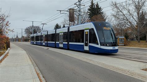

One thing I've noticed with the low floor train in Edmonton is how the overhead wiring really ruins the the streetscape gains made by using smaller curbside stations.
While Kaohsiung's LRT uses the same Urbos 3 cars that Calgary ordered for GL, theirs are powered by super capacitors that charge at the station. I'm guessing that technology doesn't perform well in winter conditions, which is really unfortunate as the difference in visual impact is significant.
Compare:
With how GL would look running at surface down Centre St.
Compare:
