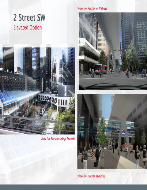

Buying Aspen Square, and making it grand central, solves many problems. The can even make it no tunnel, even stay on the south side of the CPR, and still be mostly functional, without breaking the Red and Blue lines (unlike the Steve Allen group proposal).
Or, as you're advocating, make it elevated through downtown. Considering it's a low floor train, and it's going to be bridged over the Bow for the northern crossing, I don't think elevated is a bad trade off if it could contribute to significant savings.
It would. Don't need to put a single pile into the bad soil if it really that bad, don't need to ever have empty volume if it is only mostly bad. Now it will create other problems, but whatever.
Here is the profile with the structures needed to clear in purple (CPR also needs 12 or 14m rail to structure iirc):
Definitely would be good to revisit the idea of elevated. It would solve a lot of headaches and get this through DT without intersecting the Blue/Red line.
How about a line from Seton to Chinook Centre. Skip the downtown. Not ideal by any means. I wonder how ridership would look given that people would have to transfer downtown.
Someone remind me what the CP clearance has to be? Doesn't really matter as the line would have to be even higher than that to clear the city parkade entrance off 9th Ave and the +15 that's there. I also don't know how you can support an elevated line with all that in the way. I'm not worried about the rest of the +15s along 2 Street, you can integrate them into an elevated line. The issue with elevated is where do you cross the CP tracks? Very few places can accommodate the turn radius required coupled with the need to cross the tracks. Every option comes with its own alignment affects, it's actually why I think they stick with what they have.
If can do the turn slowly, can turn just fine. All a matter of trade offs. It is all a matter of optimization. Digging a big hole turns out after 7, 8 years of trying to mitigate it, turns out to be an awful nut to crack.
turn slowly
Then isn't the answer 1 Street? Elevating between between first streets on 11 Ave, turning north through the parking lot at 11 Ave and going over the tracks? 2 Street was fine when going underground but, to me, looks impossible to make work elevated.
The elevation over the CPR (line between the two purple bits on the profile) is similar to what's needed over the spiral ramp.

Elevated is best idea, but they spent money on relocating utilities .
Be careful of the sunk cost fallacy. Also, this highlights the poor procurement strategy the City implemented. Spent a lot of money "preparing for the project" before they even confirmed if they could actually do the project or not.
