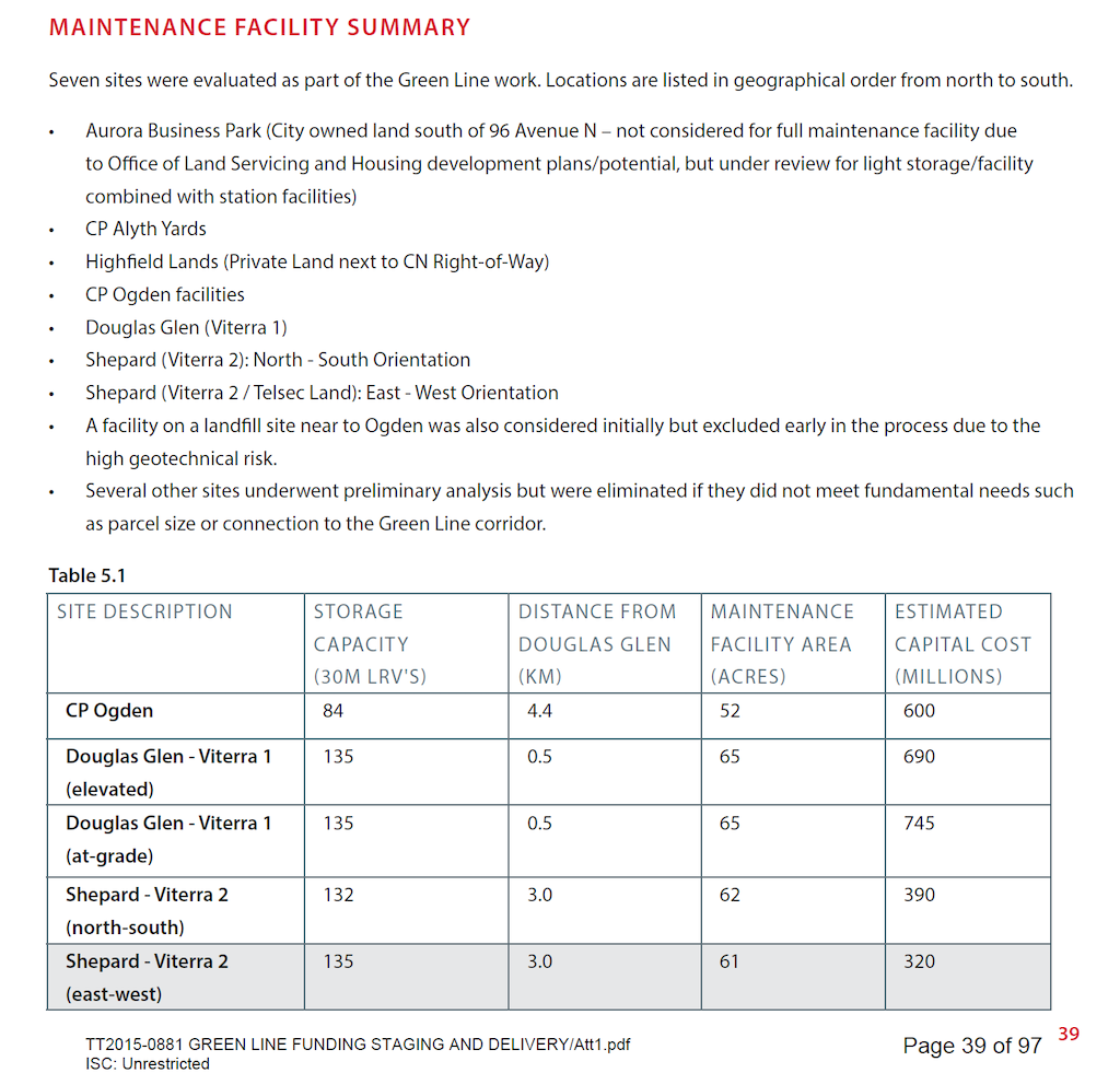

Well, Nelson has been around for a long time and he has to have gotten the $8 billion figure from somewhere, I wonder if someone on Council leaked it to him? I must admit, if the above is true is it really worth $8 billion for a line that only goes to Ogden? That's a huge cost to only serve a few neighbourhoods. Wasn't the main point of Ph 1 to get people from the populous and growing SE suburbs to downtown quickly?
I assume what they meant was $8B for 16th Avenue to Shepard with the available funding now only enough to go from Eau Claire to Ogden.
Could they not commit to phase 1 to Ogden and have the next segment further south waiting and ready to be started by the time Phase 1 is complete? Also, I thought it had to be built to Shepard for the maintenance facility.
The 2015 report mentioned that they looked at a few other sites in the SE, with a focus on CP lands in Ogden. It was probably rejected at the time because it was much more expensive and had less LRV storage capacity than Shepard.
What's the deal with the huge variance in estimated capital cost? And what's the relevance of distance to Douglas Glen? Was that just considered the minimum necessary terminus or something?
Just random factoids to make a rumour seem plausible.
