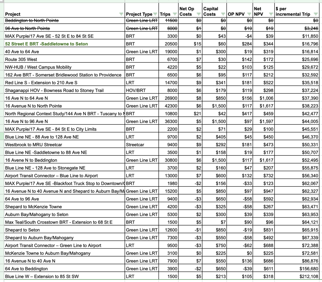

The $1B is an irrelevant sunk cost. The challenge with the Green Line is that its ridership projections aren't that great relative to the cost. Would other LRT investment deliver better cost-benefit? The current Green Line plan seems purposely designed to build a white elephant to force future governments to fund extensions. The City mismanaged it from inception by quoting optimistic cost numbers either through incompetence or deception and too long chasing the dream of a bored tunnel. Much of the Green Line right of way is easy: paralleling freight rail tracks, through industrial corridors and through a reserved corridor along 52nd St SE. This should have been a low risk project.

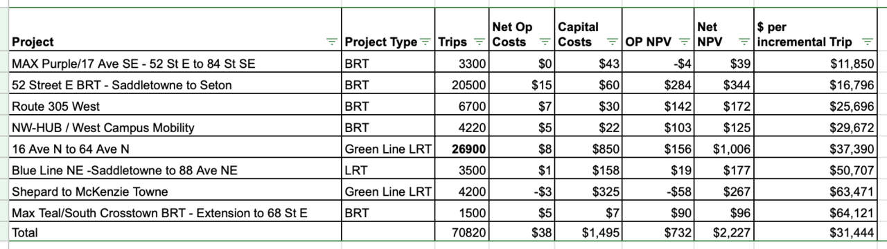

Some old math did for a client based on 2021 cost estimates including operating costs and projected ridership to see which projects were/are efficient:
Projects I recommended beyond the greenline as presented in 2021
