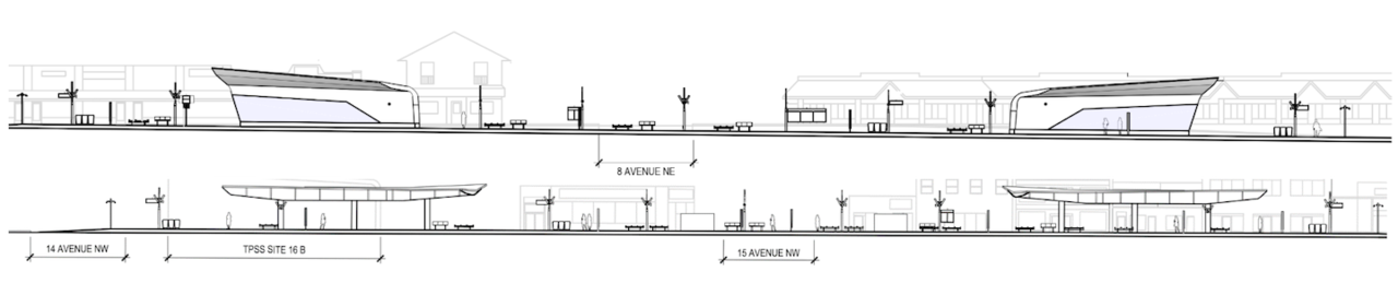

All very good points. It really comes down to the endgame goal. If the goal is to allow for a lot of growth in ridership, this design will not cut it. This design will not allow for a station that services a large volume of people efficiently and allows for many efficient transfers. I guarantee a not too many years after built as the neighborhood around it begins to adapt and redevelop the city would badly regret wasting their money on something so underbuilt when it would costs so much more in that inevitable future to fix (which will then not be done) than it would have now.
Even if traffic levels at the 16th Ave section is reduced when the full Green Line is complete, the at-grade stations IMO results in significant compromises in the desire to turn that section of Centre Street into a walkable, "cozy" main street versus stations that can handle high passenger counts and provide comfort in bad weather.
To minimize the footprint of the stations, the plan is to make them pretty spartan so they're not expected to have heated or enclosed shelters and only a partially covered platform. I'd expect them to be in the bottom 25, 20% of CTrain stations for comfort while waiting 10 minutes for a train in the winter or a heavy rainstorm. The below are side views of what the stations could look like (from GC2021-0736) and even if they are much more minimalistic than existing stations, their length will probably still be quite isolating between the two sides of the street
See and this is my problem with north of the river GL. They say this is a rapid transit project; this is not what I would ever call an appropriate terminus station for a rapid transit rail project even if only temporary (for the foreseeable future). Call it what it is, a street car. What it is is a bunch of pedestrians waiting to be hit on a chaotic 2 lane road or hit by the train, that despite crawling at 30km/h, is still deadly. And if the weather is bad, yeah forget it.
Instead of this garbage, put it under ground 9th Ave station or not, and make this stretch of Centre St a even nicer main street with consistently nice wide sidewalks and better walkability without a very long street car stop separating the community.

Regarding green line platform's, they will not be 120-140m anymore. But I will avoid going too much into detail.
Good! Shrink those station boxes. Too bad this is happening after the vehicles were purchased (alas, the 'price' of not one big contract).
