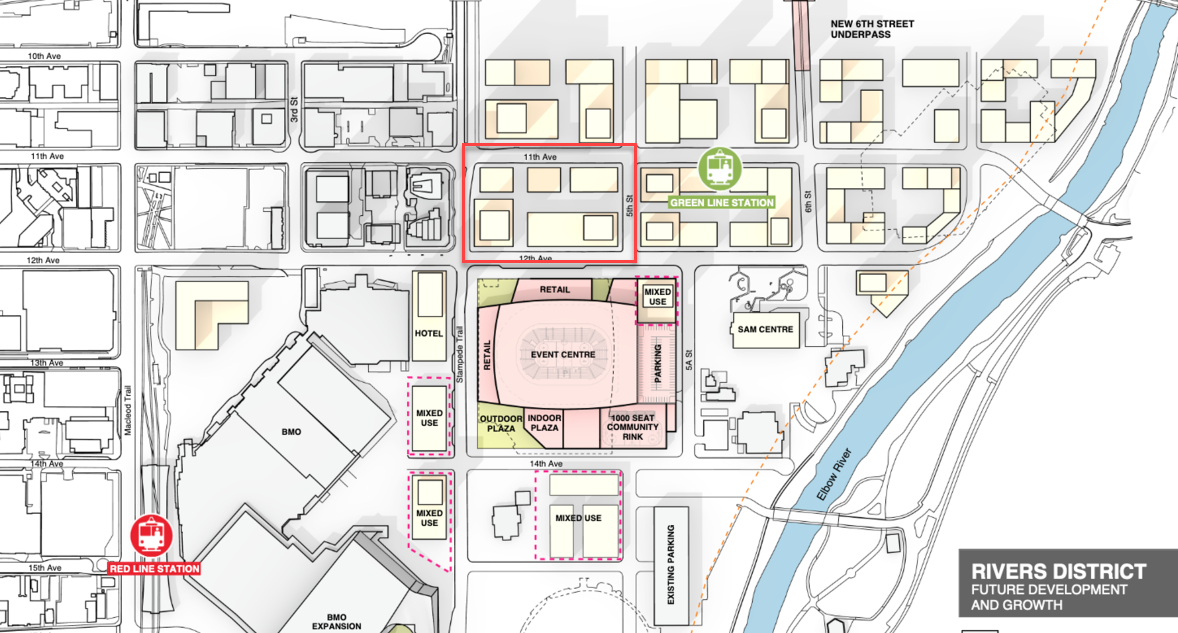

I saw this image in the Event Centre thread, but it's more of a Green Line question. I'm curious why the city didn't put the station one block west? Unless they plan to have an entrance on Stampede Trail? I would expect a lot more pedestrian traffic along Stampede Trail to/from EV also the retail is closer to Stampede Trail.
Just from a glance it looks like they're trying to put the station in the middle of the undeveloped lands north of the arena. Likely trying to maximise the TOD potential
The first draft of the revised alignment after the 2019 issues wanted to place the station between 4th and 5th Street because of the reasons you noted. However, after the functional design phase they had to move it over for operational and cost reasons.
