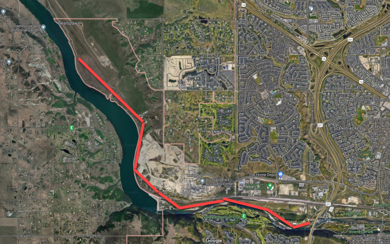

Is that second one on the Bowness Park side of the new Stony overpass?
Yep. Sadly the pathway doesn't go any where past Stoney Trail, but if they could bet a conector built from there to Bearspaw area where there's another existing path, it would be nice bike path. I believe the intended path to Cochrane would follow roughly where the red lines are.
IIRC (and I could definitely be wrong), the connection was more likely to come through the new Rockland Park community (ie. up the pathway below/parallel to Stoney that has a bridge over the train tracks and then a tunnel to the north side of Nose Hill Dr, then west along there).
Your route would be nicer, but there would be a bunch of challenges dealing with CP and the dam operations.
As of a couple years ago, there is also a hold up with one landowner between Rockland and Glenbow Ranch

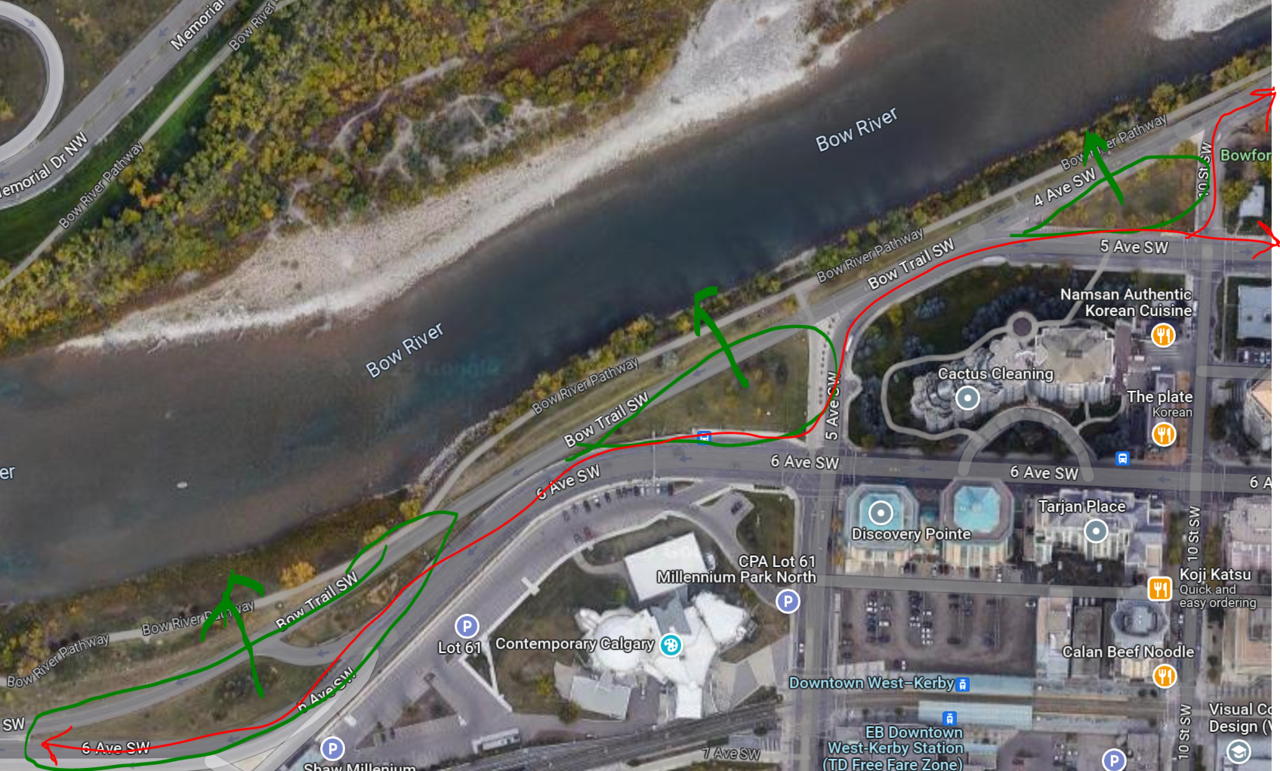

I'd like to see the current Bow Trail slip lane realigned to provide more public space along the river, either via 10th or 11th Street connecting to 6th Ave. That single lane hogs a ton of land! I know this might tick off west-side residents - but they are already spoiled with having the quickest vehicle access to downtown anyway.
The existence of the reversal has enabled traffic in the Sunalta cuplet to drop by 50, 60%, enabling the neighbourhood to no longer preferred as a high-ish speed shortcut.
If this can be the start of a wholesale change that's required (as we've discussed in the roads thread), it would be exciting. Many small changes add up.

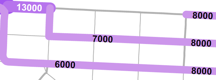

-33% on 11 ave (presumably pm peak) -53% on 12 ave (presumably am peak)
in 2000
2018:

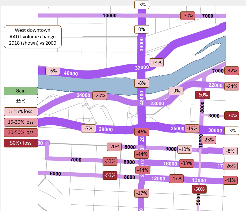

Those are average daily volumes. But it's interesting, I had a look at west downtown access at a bigger scale; here's the 2018 volumes and the change since 2000:
Traffic is down a lot on 11th/12th, but it's also down almost everywhere.

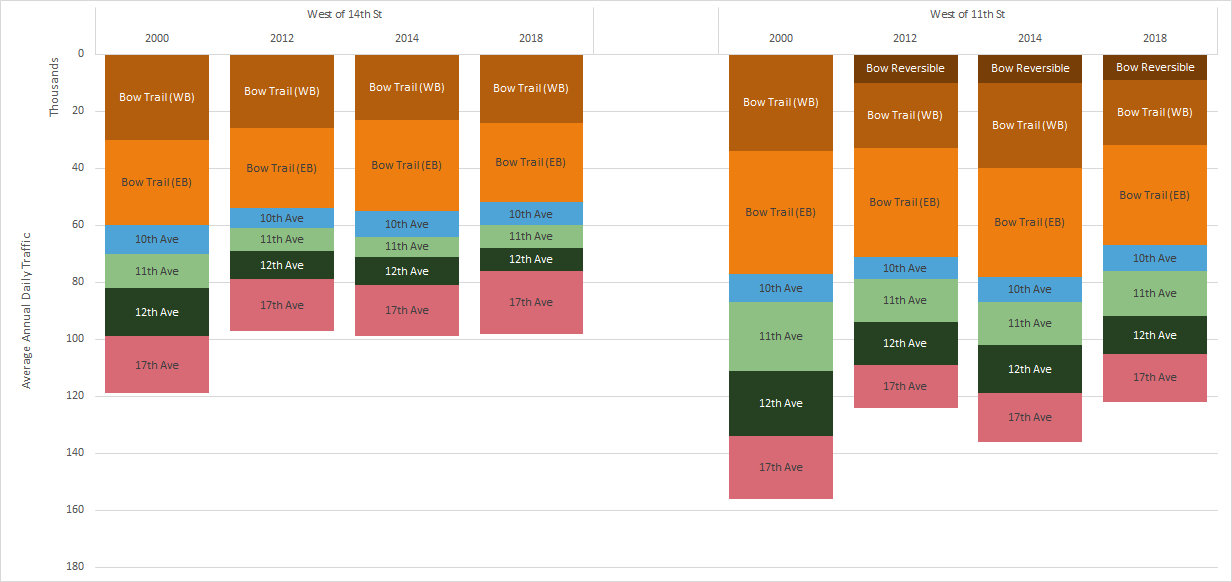

Percentages can be a little misleading, though; the 7% reduction on EB Bow Trail and the 20% reduction on 10th Ave W of 14th St both represent reductions of 2000 vehicles, just from a higher base on Bow Trail. Here's the volumes across two screenlines; one west of 14th and one west of 11th streets:
It's hard to say that the traffic on the reversible lane is traffic that would otherwise be going through Sunalta; for one thing, some of that volume was there before (since it's not reversed in the PM), and the overall volumes on Bow Trail are down.
I included a couple of midpoint years; 2014 to represent higher downtown office activity (not much change since then), and 2012 because I had a hypothesis that the West LRT (which took 30,000 cars a day off the road per the first year report) might have had an impact, but there doesn't seem to be much before/after difference. One thing that I think does have a very modest difference in Sunalta through-cutting is the cycle tracks, which reduced car volumes on 12th by around 3000 vehicles per day.

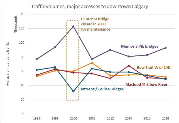

Decreased volume to the downtown is the broad trend most places:
That up point at the end on the Memorial NE bridges is a bit of a false trend (like Macleod in 2014); data's a little noisy. That volume was down again in 2019.
Long story short, I don't think that lane is really needed, particularly west of 14th St which is the narrowest, crummiest part of the pathway.
