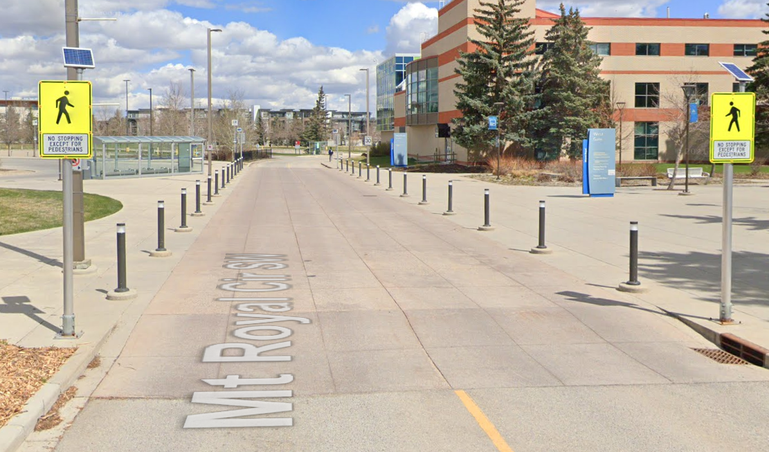

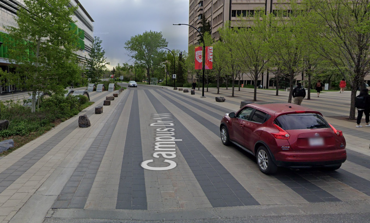

I found what might be Calgary's largest raised crossing, in exactly that context - Mount Royal University between the bus loop and the campus building here:

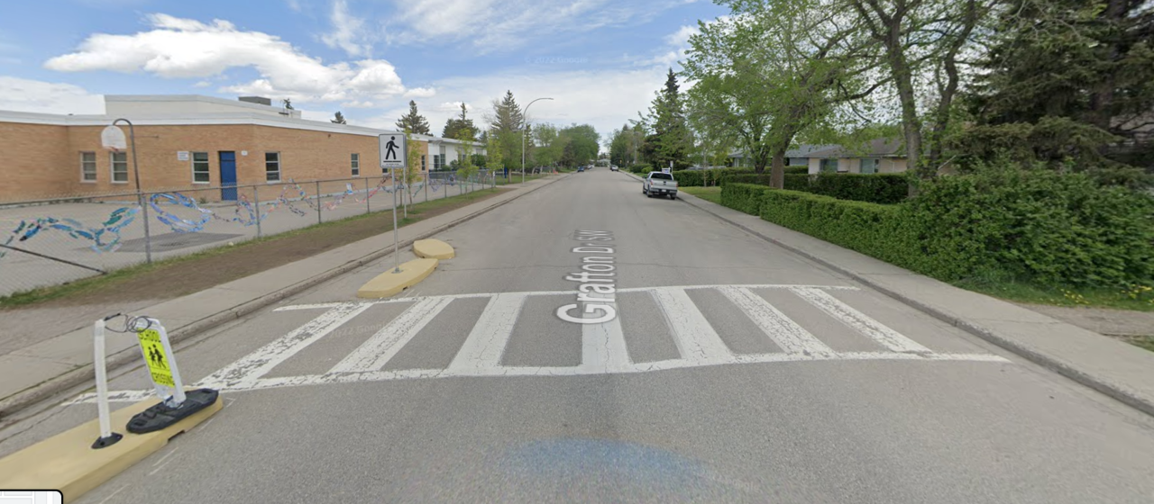

Notably, here's the nearest public elementary school's pedestrian crossing. Note the bump-out, but also the lack of curb ramps, ginormous 1950s era roads here:
The school is tucked deep into the residential community so traffic would be low, but it's the kind example where just updating our standards about how pedestrians are treated around schools to something slightly more pedestrian friendly and safe would be a no-brainer (e.g. wider sidewalks to handle rush loads of children/parents, close street during pick off and drop off, add more crossings and a raised crossing aligned with the school entrance rather than just randomly down the side of the building etc.)
Otherwise that sidewalk is likely to stay the same width with a crappy crossing until a child (or several) are injured here. I'd imagine there's about 100 schools with a similar level of pedestrian thought applied to them.
