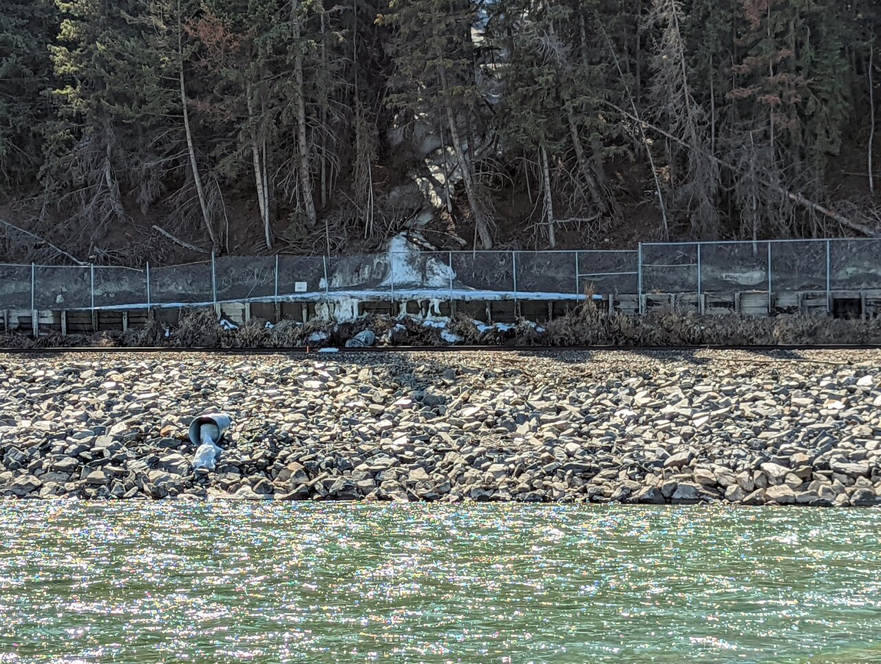

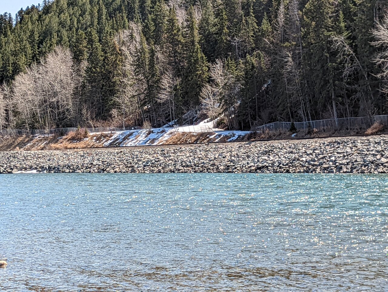

Just for a bit more context, I took these pictures from the other side of the river yesterday. Gives some context for how much ice builds up and how much work it would be to control.

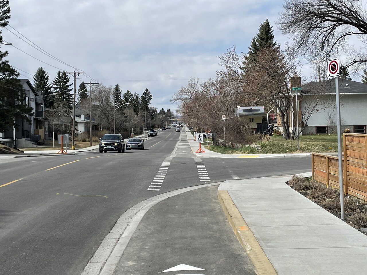

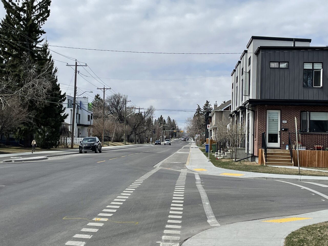

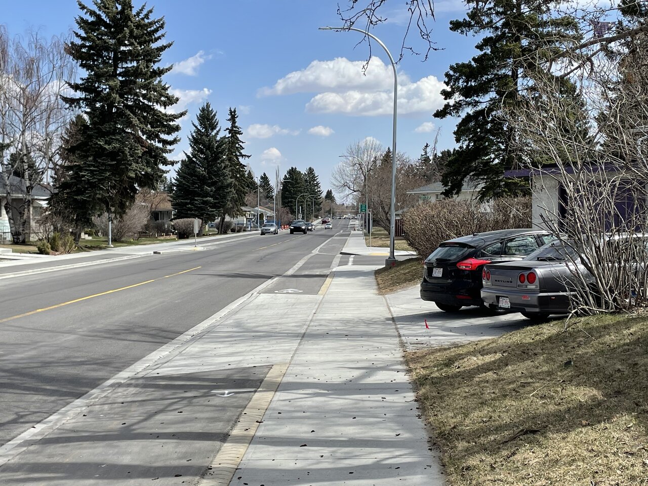

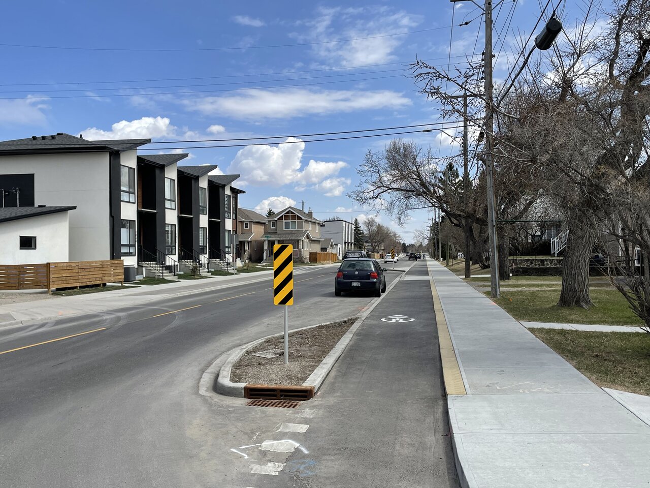

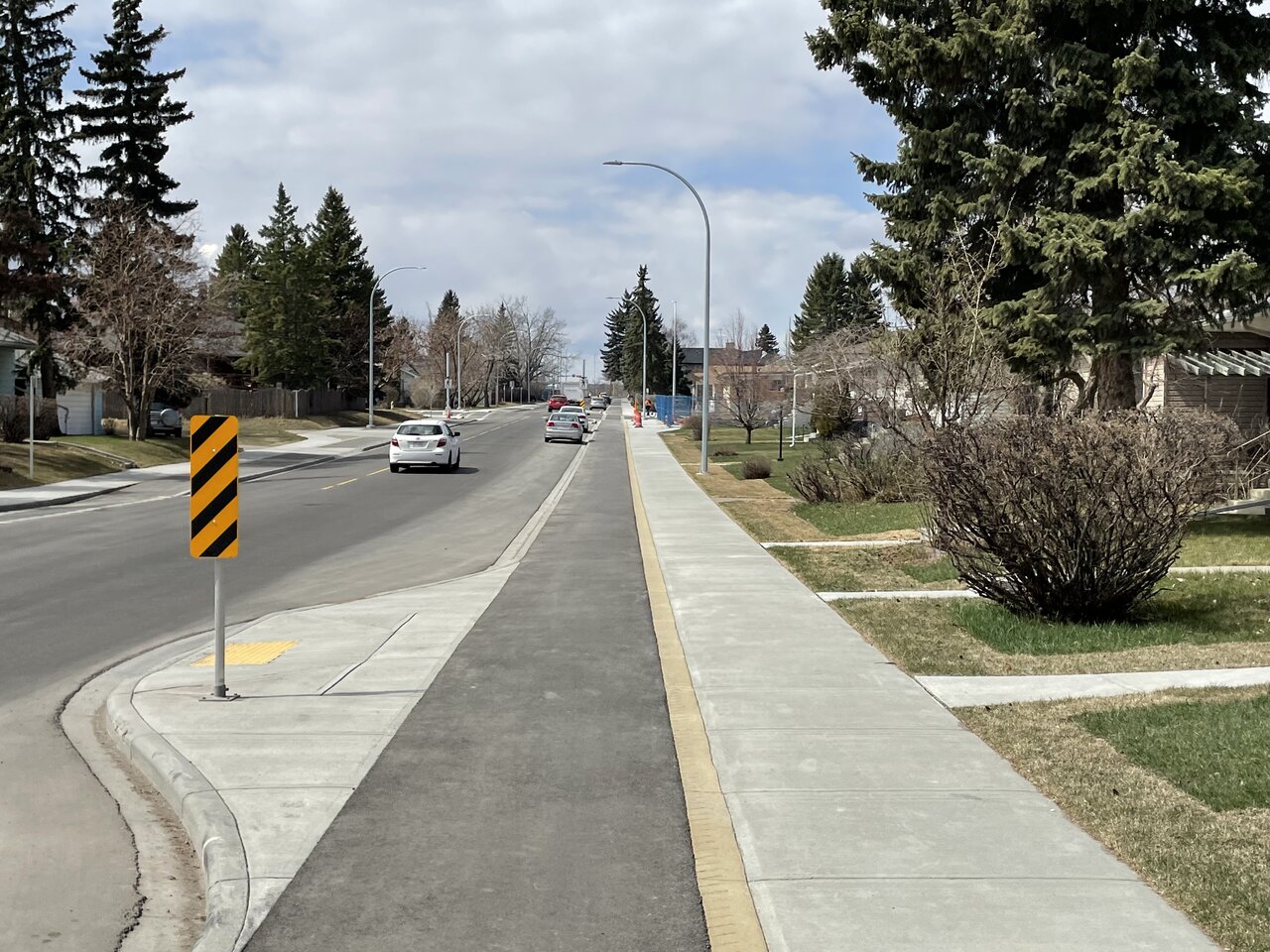

It's a good route that needed cycle lanes, but I have many nits to pick here. There are 2 not-so-obvious criteria I have for evaluating bike infrastructure:
1. Can I ride it and pay as much 'attention' as I would driving a similar route? (ie. in a car you'd be on the lookout for peds/intersections/driveways, but you wouldn't be white-knuckled and covering the brake the whole time.)
A: I'd have to ride it to be sure, but it looks like a no:
- Tons of driveways, where the bike lane feels like a visitor/intruder on the car's ramp. - Intersections feel a little messy, creating a purgatory between pedestrian/vehicle status. It should be clear that cyclists have a straight-through ROW, but I can see some ambiguity for drivers to think a 'mounted cyclist doesn't have ROW in a crosswalk'. Most of the ramps into intersections look pretty smooth, but it make it a little hairy to shoulder check for a right-turning vehicle.
2. Can I comfortably tow a child in a bike-trailer?
Maybe somewhat. You really feel the bumps when towing, and that road is a little too busy to feel great about it.
So at least for me, this is the kind of infrastructure where I'd prefer to stay on the road when solo and wanting to go fast. With a trailer I'd probably take the longer way to the north.
I'd have preferred physically separated lanes at street grade for both directions on the north side; ideally eliminate left turns onto/off of a bunch of the NB streets.

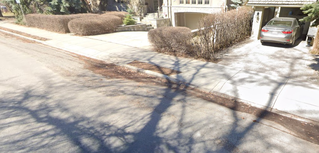

Lots of cities don't allow sloping driveways to interfere with walking or cycling pathways. That's another alternative is to change our design preference around that.
Here's an example of what I am talking about from Rideau Park, sidewalk is flat but car still gets a short, ramp:
The second issue is the intersections. Again, many cities find ways to keep sidewalk and cycling lane consistent through a raised intersection, so the cars go up and down, not the other way around.

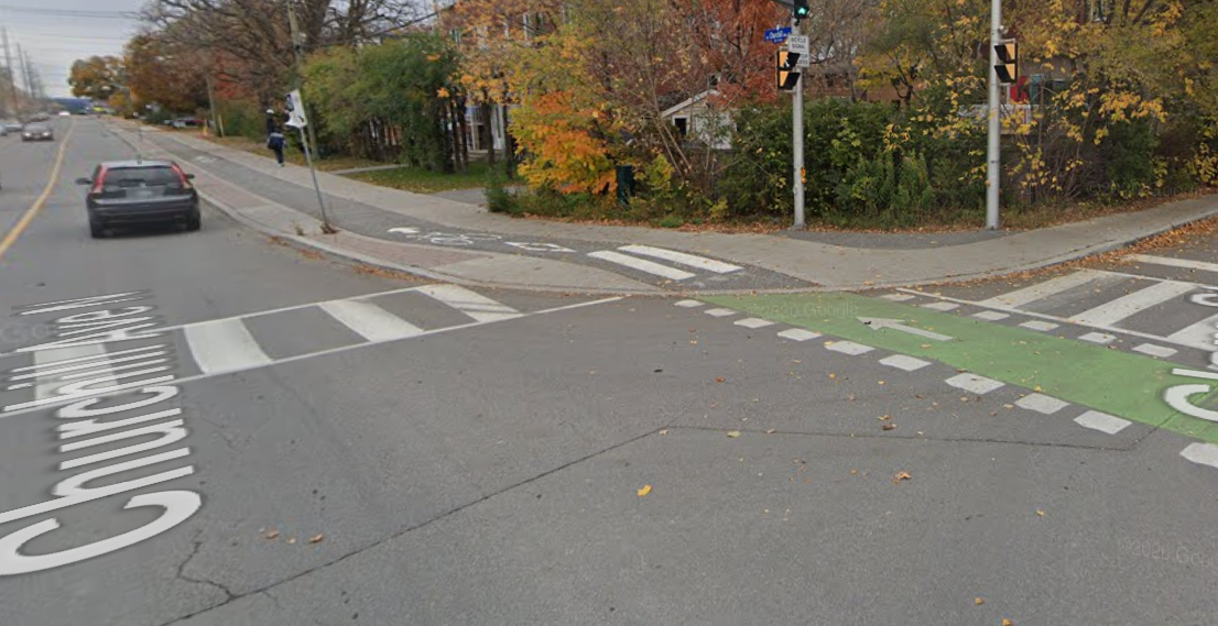

Here's an example of Ottawa where the slope of the road and height of the curb is far gentler so way less of an issue:

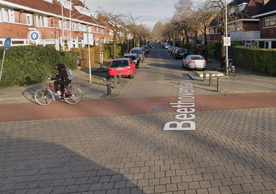

And of course the Netherlands where all this is figured out. Bicycles and pedestrians stay at same level and in a straight line of travel, car just rise up to their level then come down again after:
In general it's the same old story, trade-offs were made of 24 Ave that favour drivers and vehicle status quo. It's still such a big improvement so 100% support the new look, but unfortunately couldn't crack some Calgary car-oriented standards:
  • Wide curve radius preserved for turning vehicles force peds and cyclists into non-straight travel paths at intersections
  • Height of our curbs and slope of the road is very high and preserved so peds/cyclists have to go down to gutter then climb out to the middle of the road, then down to the gutter again (side note - I have never understood why this is so pronounced here; most cities have far shorter curves and less steep roadways even with way more precipitation than us)
  • Driveway slopes prioritized over pedestrians and cyclists having a flat travel surface.
