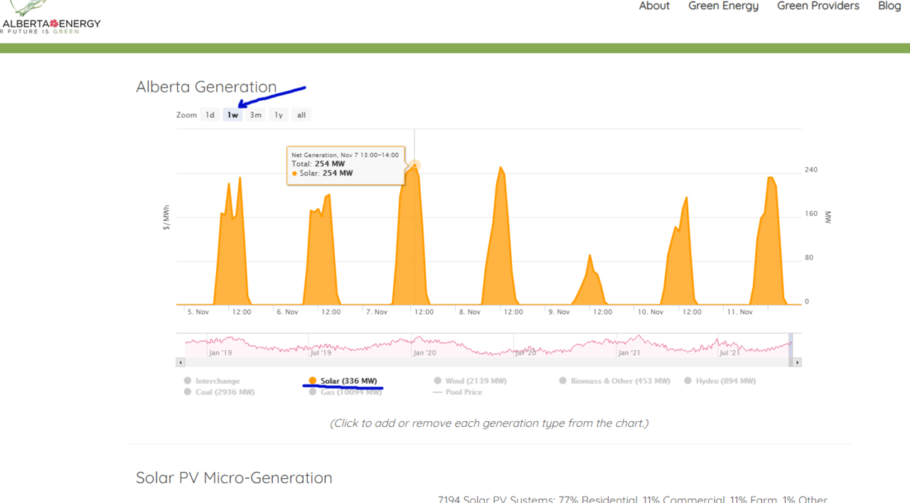

For a good idea of general consumption and generation method, this site does a good of showing it. You can drill down to specific days of the year to see the changes in generation of different methods.
You can remove the other generation methods by clicking on them. This for example shows only solar power generation for the past week. On the 7th, it peaked at 254 MW generation, out of a Max Capacity of 336 MW (Matches the MC shown in your chart) But total Generation can be found in these day to day stats.
Awesome site. I could spend all day on there lol.
