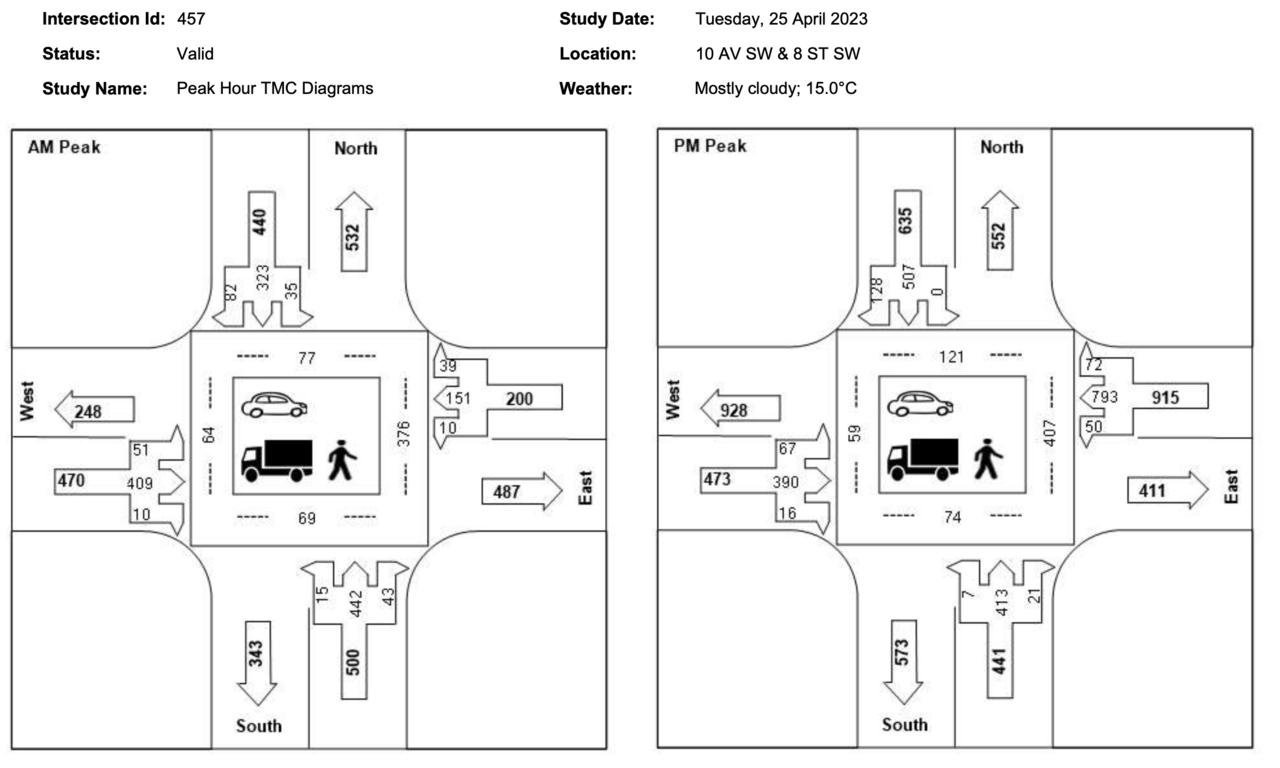

I was curious about relative traffic in the other underpasses. (important caveat: these are not from the same day or month, but pretty sure they are all between Tue-Thurs within the last 2 years or so)
NB / SB
14th = 22700 / 24500
11th= 2300 / 6300
8th = 2800 / 2600 (I wondered if this might be an anomaly so I checked the previous study which was 2018 = 3100 / 2600)
5th = 0 / 12500
4th = 10400 / 0
1st SW = 5800 / 5300
1st SE = 0 / 24800
Macleod NB = 22000 / 0
4th St SE = 3900/7600 TUE; 4200 / 7400 THU; 3500/7000 SAT. - All 3 studies were Flames home games from last October...couldn't find an event free day but didn't look very hard
In total there are about 14k more cars going SB than NB (but again, flawed total from a bunch of different days). I would guess that is drivers using 9 Ave to get to the beltline or Macleod Tr, but then their return trip uses another route? This applies to me fairly often as I live near Bow Tr. There's probably more to it than that...
1st SW and 8th St SW are similar to some degree, but of course 8th goes under 9th with a funky entrance from the west approach, but 8th should have a lot more capacity available.

Unfortunately there is a data hole at 11th St and 10 Ave, so we can't really determine where those 6300 SB cars are going

Hard to make any big conclusions here, but we are talking about 2-5 cars per minute NB, and 7-8 cars per minute SB
