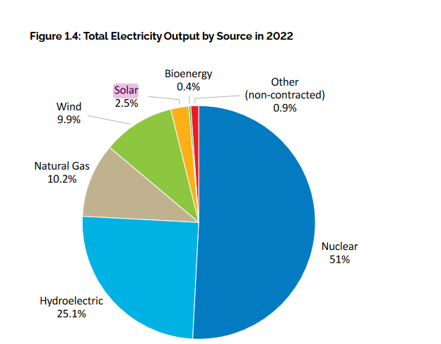

This graphic of sources of power now is interesting to me. (not installed capacity, but power as generated)

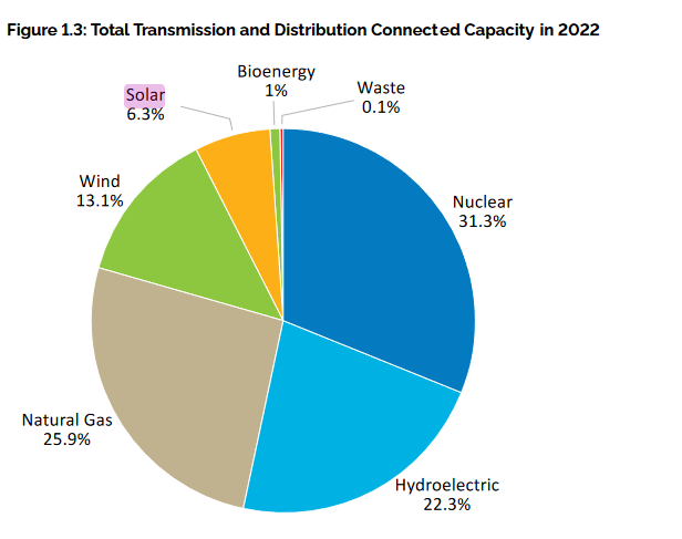

This (below) is the installed capacity. Presumably storage solutions will bring the above closer to the below, in respect of solar and wind:

This is a good graph that highlights what kind of power sources are used for base load power (Nuclear, Hydro), and which are used for peak power supply. Natural gas despite being 25% of installed capacity is only 10% of generation as its only used during peak periods to cover gaps.
Not sure how they treat wind and solar in that chart. They typically have a pretty low capacity factor (how much power they actually produce vs their theoretical rated 'nameplate' capacity) due to intermittency of weather conditions. Similarly, gas would tend to have pretty low utilization owing to its role as a provider of peak power.
