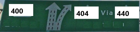

400 <-> 440 <-> 404
The signage would look something like this. I can already see some confused drivers.
And yet in Montreal, they do fine with the 40, 440, and 640 signage in quick succession (even the 540 until recently when it was renumbered to 30). Not to mention the 20, 520, and 720 (though that was recently renumbered to 136). Yeah, I know there's a logical system to it, but I doubt many drivers are aware of the system (which has always been broken, with missing segments. You see similar in the USA.
40, 440 and 640 have 3 different digits between them (0, 4 and 6) and one of the highways is 2 digits while other two are 3 digits. While 400, 404 and 440 have only 2 digits between them (0 and 4) and all of them are 3 digit numbers.
40, 440 and 640 may be in quick succession. Here, we are taking about 400, 404 and 440 all on the same sign next to one another.
Speed limits in Ontario are usually higher than Montreal. Faster the speed, lesser time you get to read.
Signs in Quebec are usually bigger with much better arrow markings.
So, I don't think the comparison is relevant in this case.
