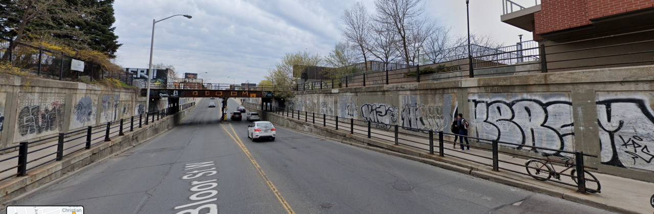

Imagine if they could build up the new Bloor bike lanes at sidewalk level (but separated from sidewalk!) through the underpasses? Then they could have an easier access to the staircases.
That would be great. I am curious about what they will do at the Barrie and Kitchener line underpasses in general. It isn't necessary for the bike lanes to dip as far down as the car lanes, and it would be easier on cyclists if they didn't have to go as far back up. The Kitchener underpass is also particularly bad for flooding during bad storms which consistently chews up the road. That said, I suspect they'll just paint some lines and maybe add some bollards like they did where those lines cross Dupont.

From Google, at this link.
This is the one just east of Dundas Street West, at the Bloor GO/UPX Station.

And this is the one just west of St. Helens Avenue.

If they could raise the bicycle lanes to be level with the sidewalk, it would be better. But will they?

Of course they won't - you think this cheapass municipal government will actually spend extra money to ensure cyclist's safety?
As part of the Davenport Diamond: Guideway & Greenway project (see link), it will include removal and reconstruction of new Bloor Street bridge.

Since this would mean a rebuild on the railway bridge, it would be a good opportunity to include a RAISED bicycle lane and pedestrian sidewalk under the bridge.
You would probably have to discuss this with the appropriate city officials, who are currently designing the bike lane.
Attack on two fronts. Metrolinx and the City of Toronto. If Metrolinx is rebuilding the bridge, they'll be in discussion with the city for road closures, abutments, widening, etc.. So have the city get Metrolinx to include the raising of the bicycle lanes to be more level.
Maybe get rid of the girders currently separating the sidewalks from the roadway and the girder in the middle of the road.
