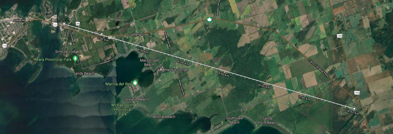

For Toronto, there's another issue though, using the original connection to Bala would take you 16km away from Toronto; which then necessitates backtracking that same 16km, thus adding 32km to the trip to Toronto.
I'm certainly not opposed to relaying track if there is a case for it; but I don't think the case would be commuter service for those in Orillia.
At most, looking to use Bala for an Orillia Toronto connection only makes sense to me if you build a green-field ROW connecting to the south-east from Atherley.
