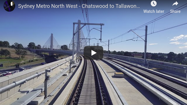

This is a vid from South Yarra to Dandenong to highlight all the changes that have happened on this line (main S.E. Melbourne line), to summarise posts at the start of the thread: new train sets (bigger, more energy intensive), huge amount of level crossings (the elevated sections were done in first term of current government, the outer branches are going to be done in this term), vast upgrades to track (although as you can see at Caulfield it's still messy as hell) and catenary.
The train/vid is on the Frankston tracks from the start to Caulfield and moves over to the main Pakenham/Cranbourne/Dandenong tracks (he also gets the station names wrong in that first segment), but from Caulfield (10m14s) to Oakleigh (17m30s) that shows you the first new elevated section (level crossing removal project).
I only just noticed that there are new segments almost every 500-600m (well there's at least one change in the wires between each station) and compared to the old setup, the new catenary has three wires above the contact and carrier wires.... perhaps this is the alternative to double-wiring like in NSW?

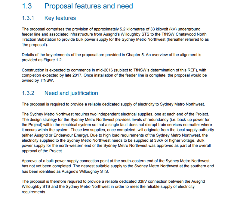

^ There's a surprising amount of emphasis on 'redundancy' for the electric grid supply for the system. I'm unable to find an exact answer, will have to delve into some pretty steep engineering reports aimed at electronic techs like myself, but take note of this:
https://www.sydneymetro.info/sites/default/files/combined_sydneymetronorthwest_willougby33kV_REF_20-10-2015-accessible.pdf?ext=.pdf
Here's a wild stab at what might be happening: Those "twinned" contact wires may be being fed (or eventually intended to be) from two separate sources. Without getting too technical, each feed, since it's DC, can be 'isolated' from the other with a 'blocking diode' (think a water backflow check valve) such that the panto doesn't 'short them together' but supply comes from the contact wire with the higher voltage. If that wire then 'sags' in voltage due to the load, the other wire is then available to also supply the load (voltage, depending on the diode stack, will be as close as .7V one source to the other) and so supply redundancy is achieved without 'isolated sections', and if one source fails, and the other wire is being fed from a separate grid main that isn't affected, the supply isn't interrupted.
That's pure surmise on my part at this time until I can find out exactly how they're doing this, but *some sort* of redundancy is at play, as the cheapest option would be to just use a much thicker contact wire.
This may also be why it's apparent in only outdoor locations, as that would be the environment most prone to overhead interruption.
No matter what's at play, it's highly intriguing! Any hints you can post from your local forums most appreciated.
Emphasis: The Sydney Metro Northwest requires two independent electrical supplies, one at each end of the Project. The design strategy for the Sydney Metro Northwest provides levels of redundancy (i.e. back-up power for the Project) within the electrical system so that a single fault does not disrupt train services no matter where it occurs within the system.

This is genuinely intriguing, as there's definitely an emphasis on "redundancy" and I know instinctively the 'extra' overhead infrastructure is connected to that (what else could it possibly be in a new-build?) but I don't know *how* they're doing it technically.

OK...this is proving my surmise! The contact wires are being fed independently from their 'messenger' feed wires. I'm a bit uncomfortable with using the term "messenger" as it means something else in electronics, but it is used in electrical engineering, as per "three way switches" having "two messenger wires".
Whatever, redundancy is being achieved in this arrangement, no matter how it's sourced for power.
