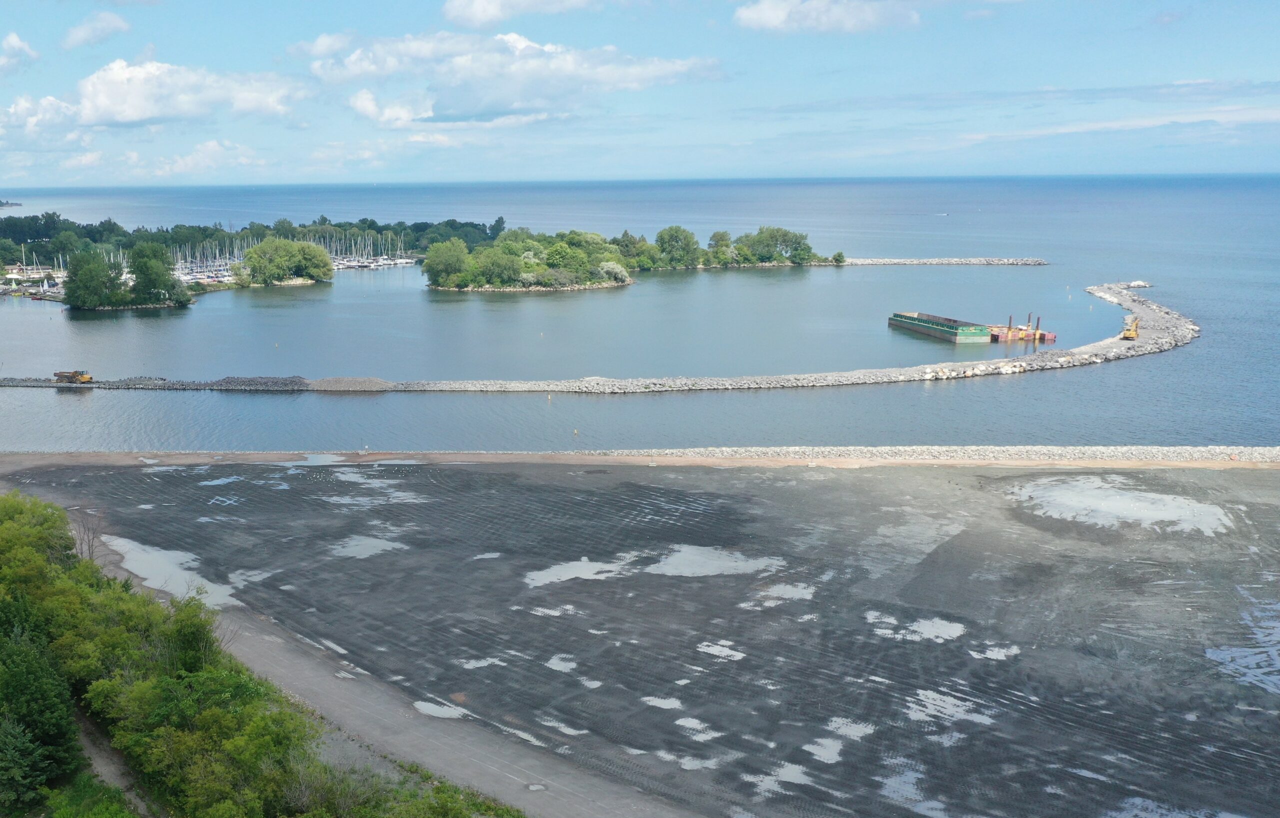

A different perspective posted on the TRCA's Facebook page:

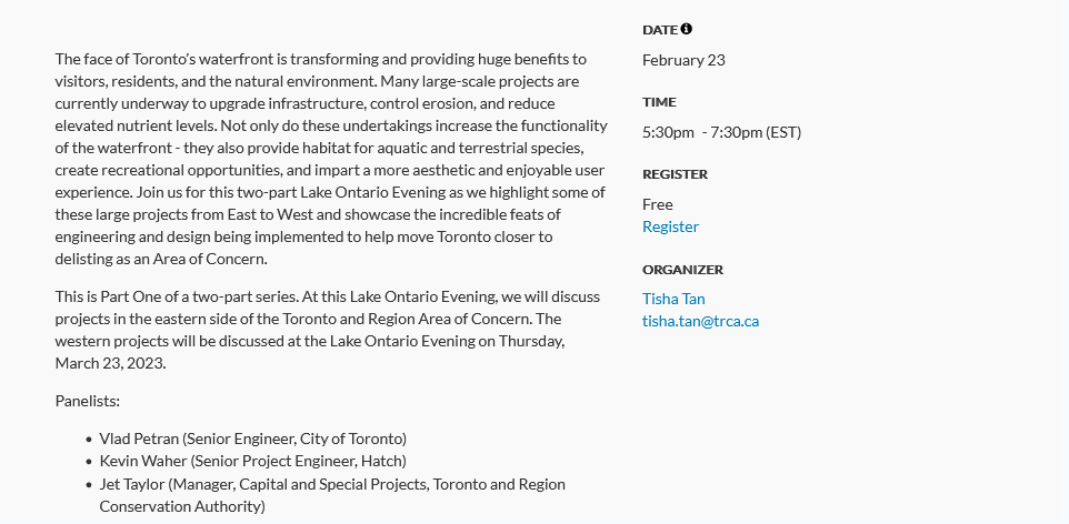

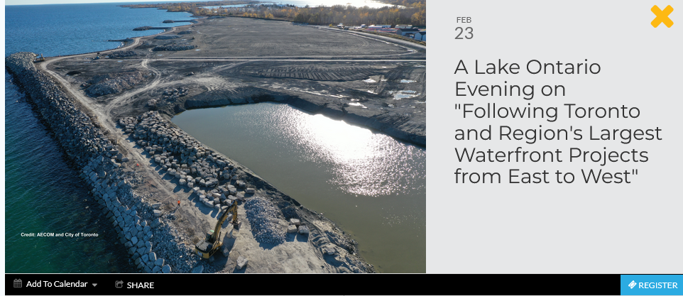

That picture was posted in support of an upcoming event which some of you may be interested in:
Event Registration Link: https://us02web.zoom.us/webinar/register/WN_rTl_PHtRSjuR2kKc2MKrig

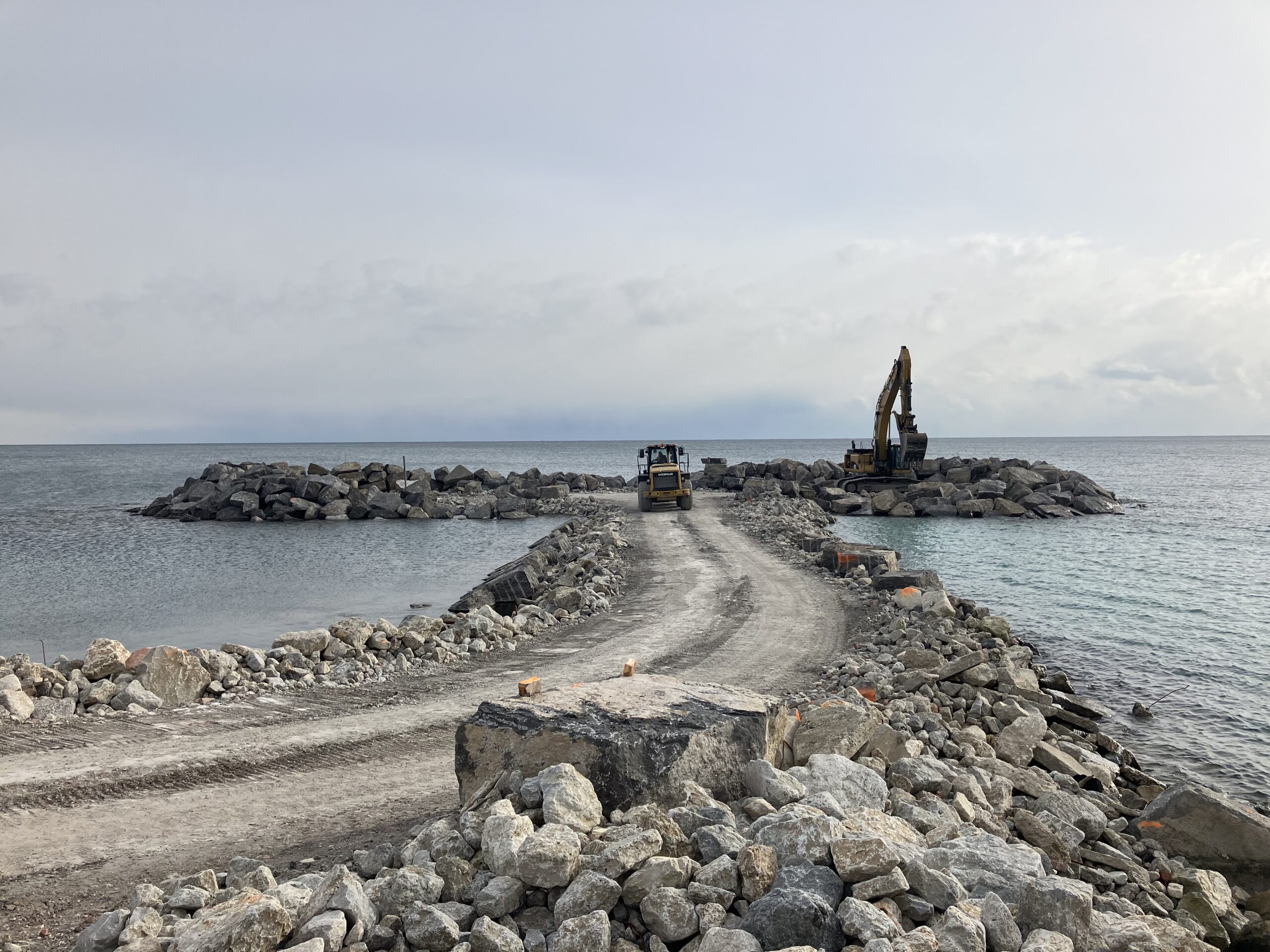

Active construction on the Western Headland. Source: TRCA, November 29, 2023.

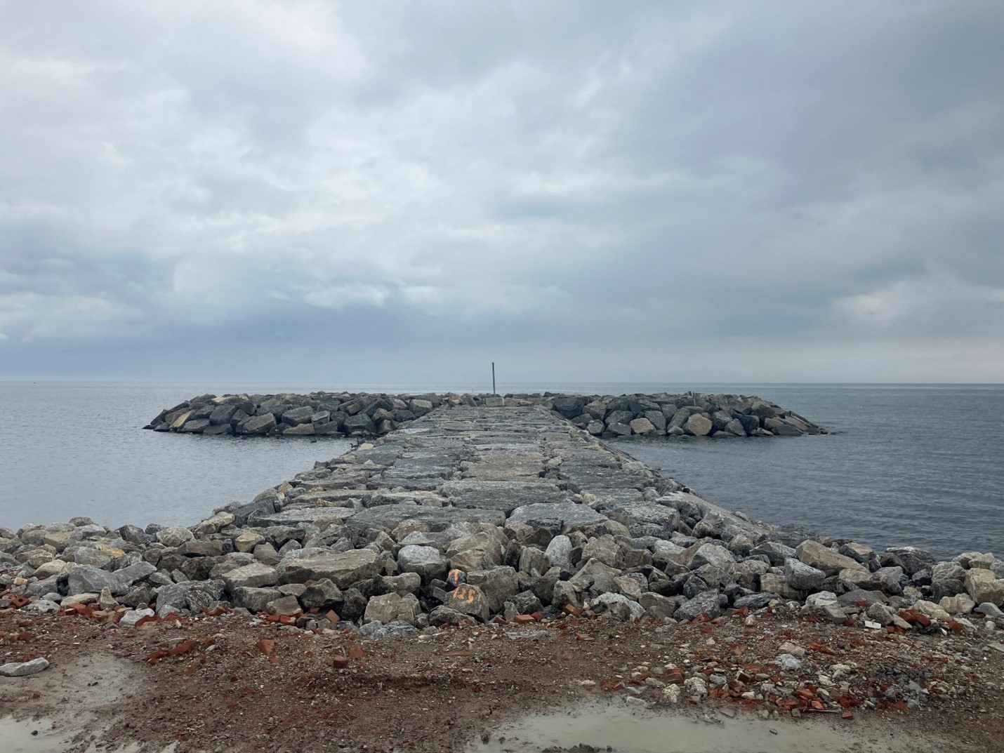

Completed construction of Central East Headland. Source: TRCA July 27, 2023.

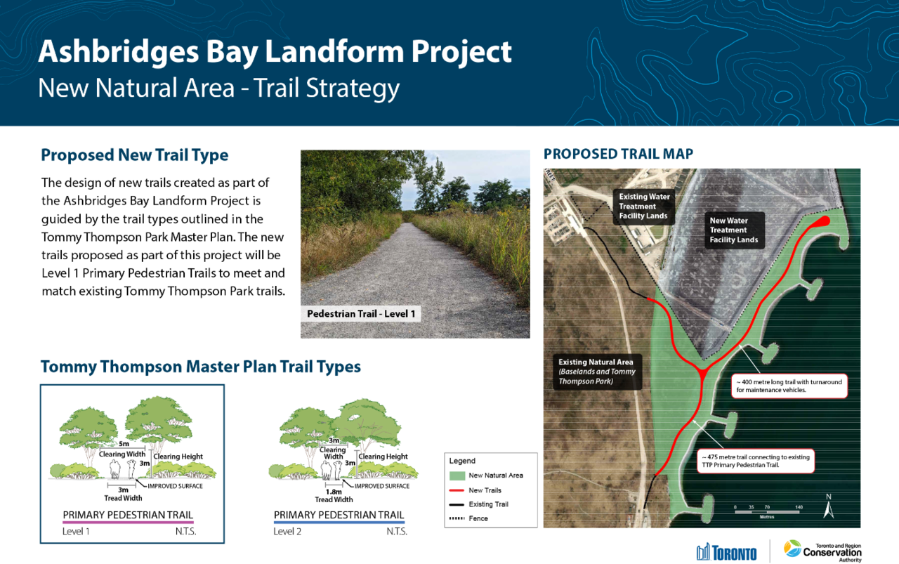

The meeting on this project was yesterday and the slides are now up:
From the above:
Direct Link to survey:
From the above:
And here I thought the whole perimeter was going to be public access. That's a little disappointing...guess I have some updates to make to my datasets.
No, the public area is a (welcome) added benefit of the other parts of this huge project. Of course, I too would have liked more publicly accessible land but....
