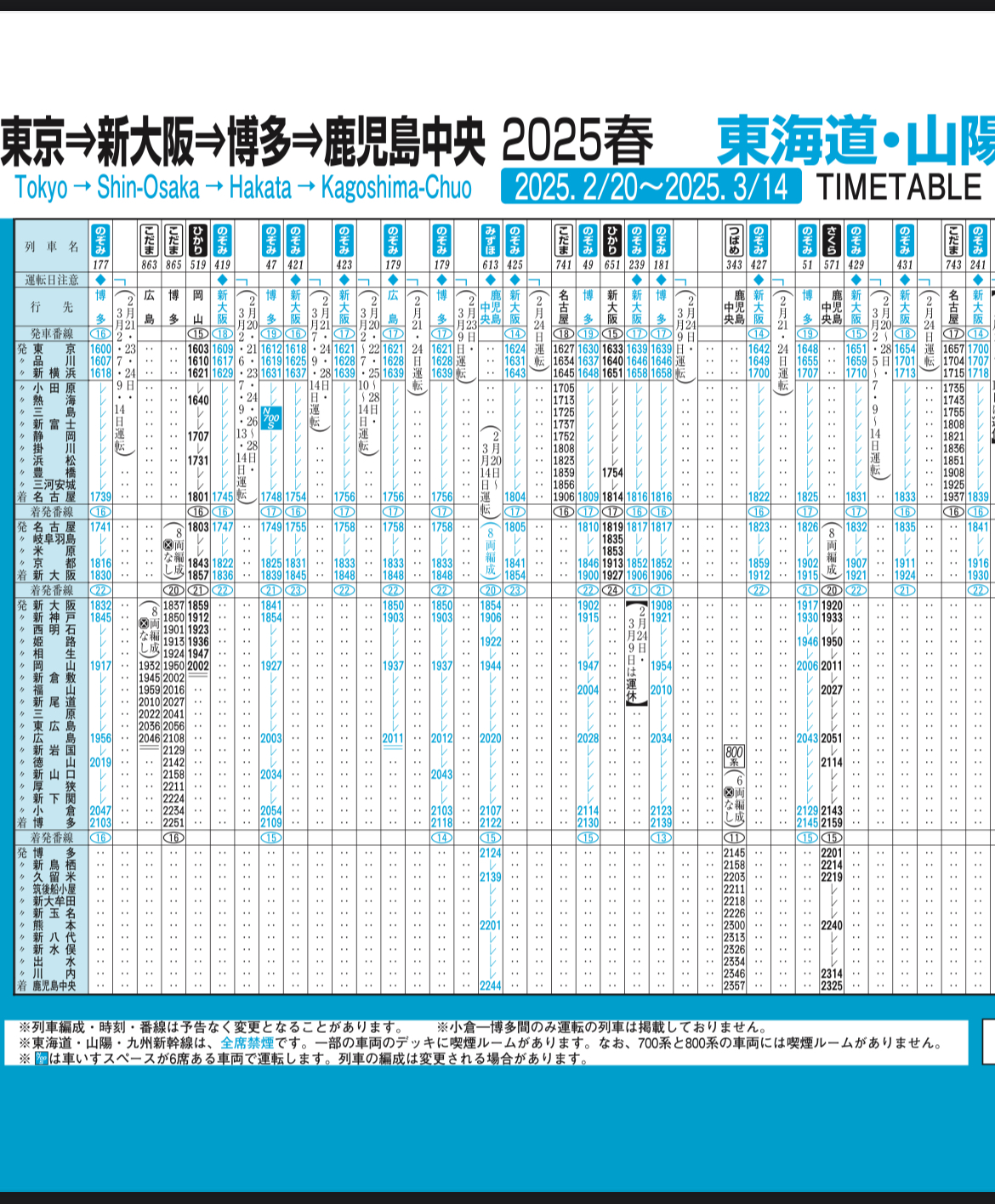

Rail Simulations Analyst here (i.e., my employer pays five-digits just for the software licenses which allow me to answer questions like these): What kind of service patterns (frequency, design speed, stopping pattern) are you expecting so that it could possibly justify 4 tracks?
Have a look at the Tokyo-Nagoya-Osaka Shinkansen schedule below which operates 16 trains in a single hour with rather diverse stopping patterns over a line with only 2 tracks (though complemented by 2 additional platform tracks at most stations):

So, a 2 track network with all stations having 4 tracks? I am guessing they use those station tracks as passing sidings?
I doubt that we'd be looking at anything like that for decades or more.
I haven't heard if this HST will have some 1- track sections worth passing, like some of previous concepts. (Though they've got years to change that 5 times)
