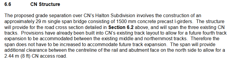

Construction on the Goreway Drive, bridge in Malton has started. I can't find anything that says the opening underneath the bridge will be wide enough to accommodate extra tracks. If the bridge is built to only accommodate CN's existing tracks, then is it fair to say the "missing link" is dead for CP?
EDIT: Now that I think about it. If CN is helping to fund the construction of this bridge (alongside the government), how would they feel seeing CP trains going underneath it?

I looked it up, here:
https://www1.brampton.ca/EN/residen...nal esr and appendicies-080512-compressed.pdf page 75
From the above:
Built with 3 tracks and room for a fourth.
Render:
A fourth track, which would be owned by CN. Which would mean no space for CP tracks.
I work for CN rail at the Brampton intermodal yard. Engines sit idle right before the crossing here after we've connected/ built the train. We then have someone drive the crew from the yard, along Steeles and down Goreway towards the idling engine. Hence the roadway beside the bridge. If CP trains were allowed to pass through the York sub, it would interfere with this process. CN wouldn't want their conductors waiting for a CP train to pass before being able to board.
If this alignment were part of a future missing middle, four tracks are sufficient for purpose.
The entire York sub is owned by CN today, and there would be no change in ownership until there is a change in ownership (if applicable); or a co-production agreement were put in place or w/e other solution brought forward.
There is no need to allow for 5 or 6 tracks here.
CN won't allow CP on those tracks. Aside from blocking the crews trying to access their train. Allowing CP trains through here would impede CN moving trains into and out of the Malport yard.
