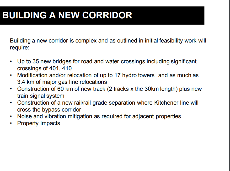

Interesting that the threshold is 32 km. There's a Metrolinx slide that says the Bypass would be 30 km.
^ I thought I was comparing with the same units. The subsection Paul provided mentioned 32 km and the Bypass slide I showed said it would be 30 km. Am I missing something? Apologies.
Sorry, misread the thread as trying to understand the odd number of 32km. Apologies.

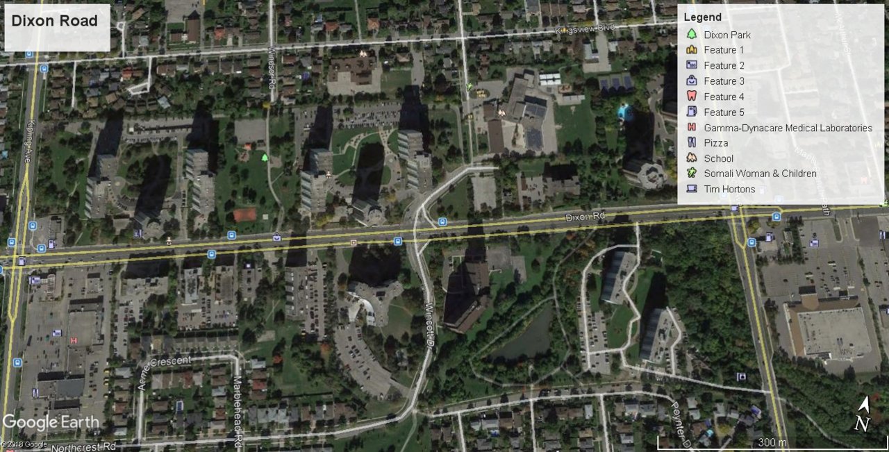

The prospect of having a heavy rail corridor running along Dixon would be even more controversial than when Smart Track was proposed along Eglinton West. Between Royal York and Kipling, Dixon is residential with a cluster a tall rental apartments and condos and two major commercial nodes at Kipling and Islington.
Also a bridge crossing would be required at the Humber river which would be costly and complex.
