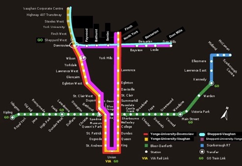

With interlining, I imagine people from Don Mills would go down Spadina instead of Yonge. Same with riders from Bathurst.

Maybe if there was only a stop at bathurst between yonge and Sheppard west it would be fast enough to justify the longer route. With three stops there isn't a chance.
The addition of Senlac and Faywood (and Willowdale) wouldn't add that much to the travel time since they'd be spaced a kilometre apart regardless. Acceleration/deceleration time of trains is like 20 seconds. At worst Yonge to SheppardWest Stn would match the existing Sheppard Line's run time of merely 8 minutes from Yonge to Don Mills. So 16 minutes end to end roughly.
That's a lot of extra time when seats are available on yonge that far north. I think you guys are being super optimistic in your calculations of how many people would use this just to justify the line. And I actually would like to see the subway extended both west to Sheppard west and east to Victoria Park. But I'm not about to lie to myself about how many people would use this
It appears Sheppard to Union is 28 minutes and add 5 minutes to transfer = 33 minutes.
Sheppard West to Union is 30 minutes, add in 8 minutes (@30 km/h) from Y-S to Dufferin = 38 minutes.
Thus, the trade off is 5 minutes versus a guaranteed seat. I can see many choosing the seat.
What if the persons stop is at king,queen,or dundas. All of a sudden your trip went up 1-3mins while the yonge alternative went down 1-3mins.
