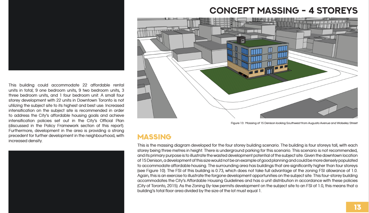

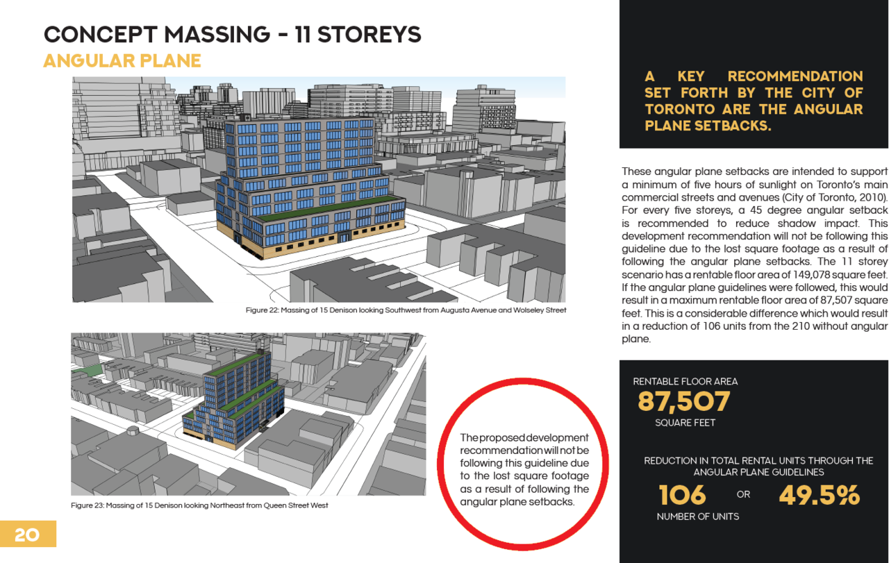

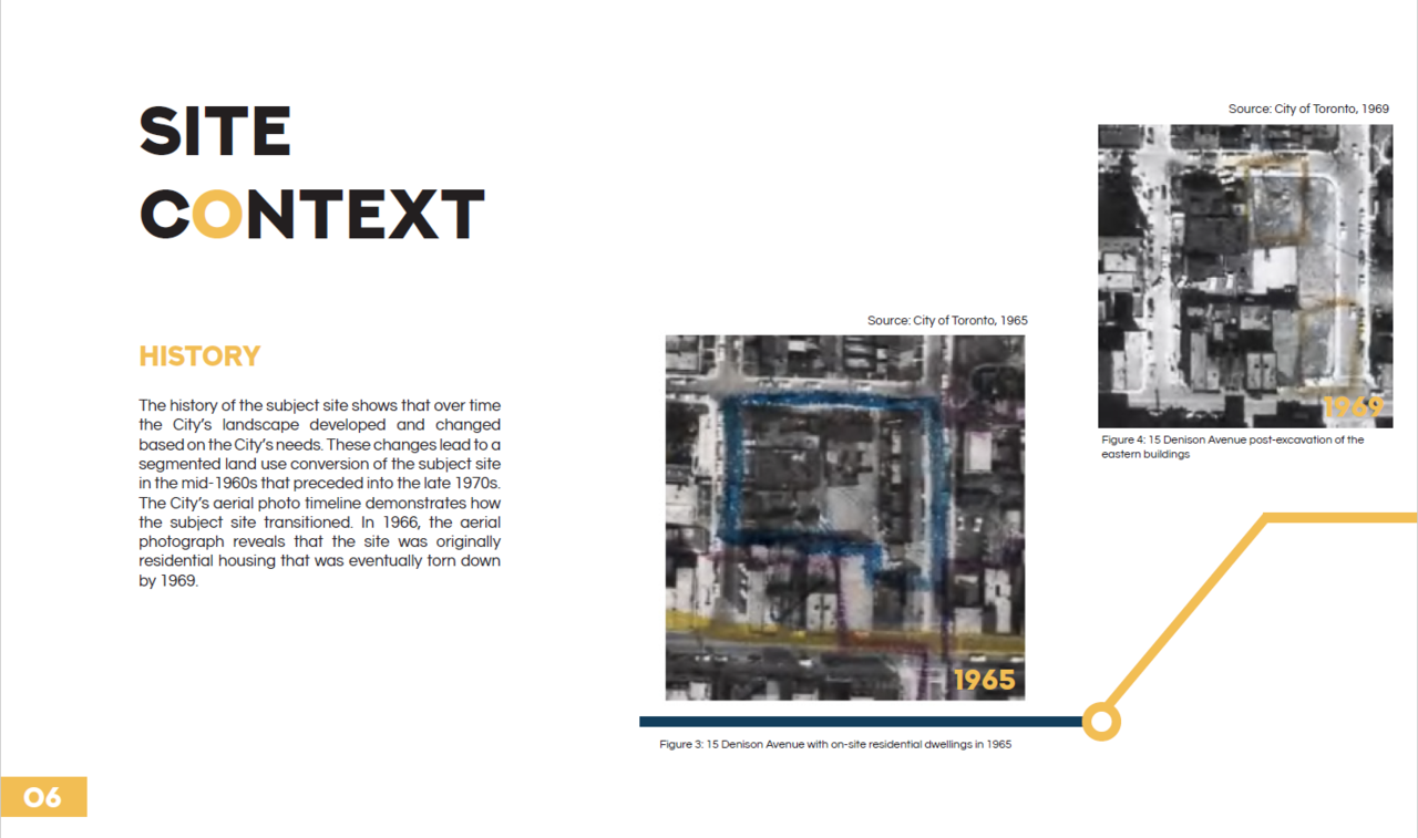

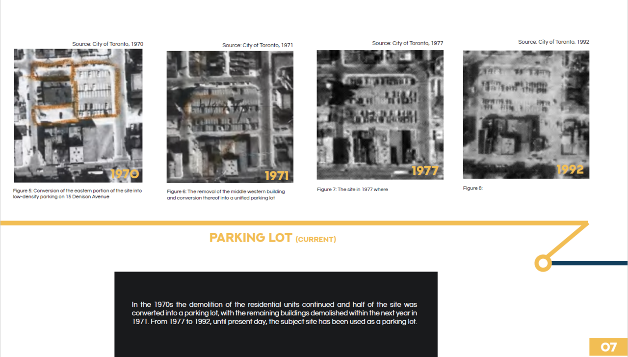

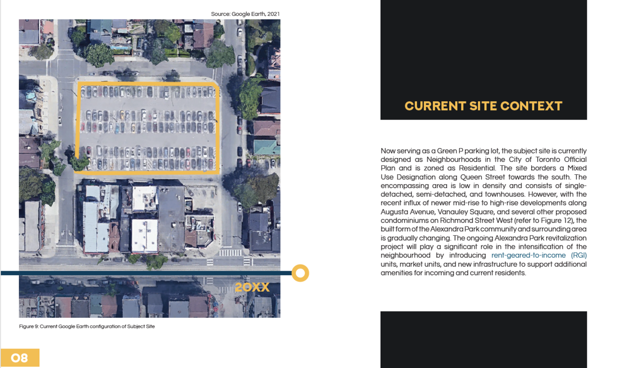

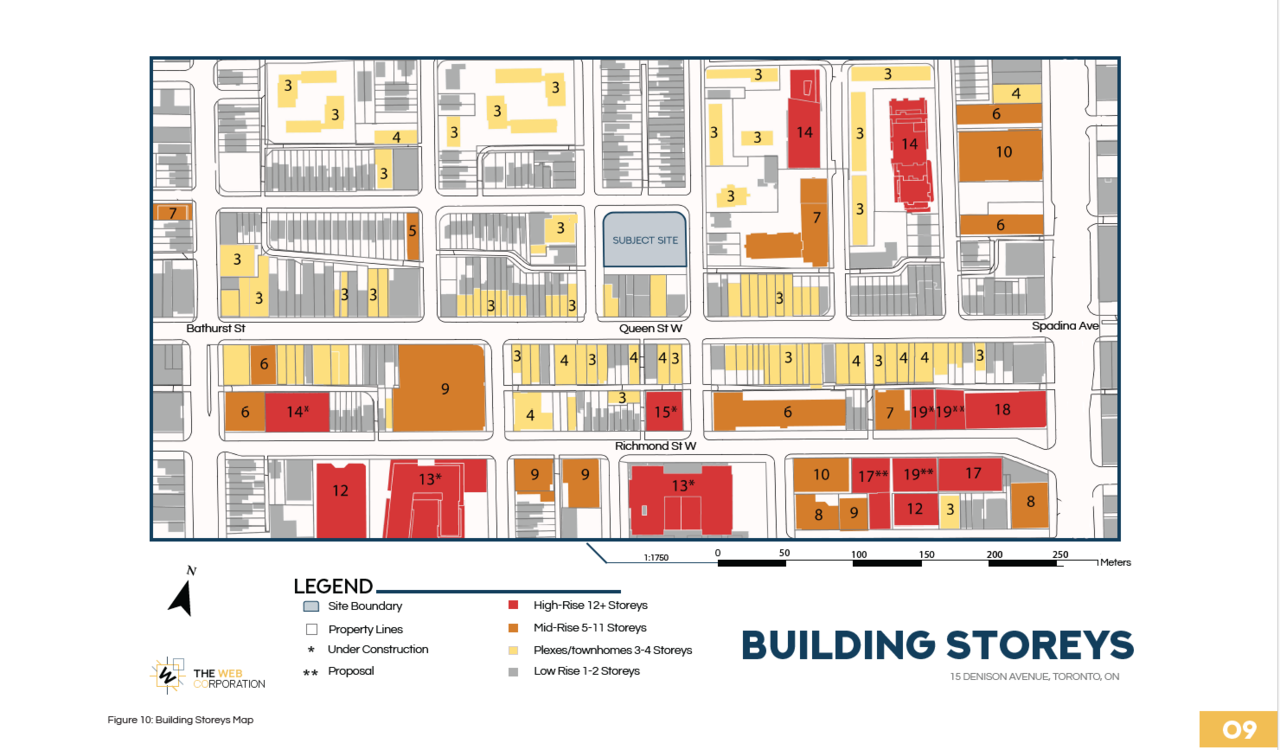

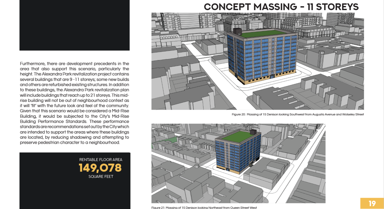

Here's some additional materials about that GREEN-P site on Denison from our TMU SURP Student team's work back in 2021 -
HISTORY
CONTEXT
MASSING ALTERNATIVES (Mass-Timber / Rapid Modular)

All the concepts above are sub-optimal.
Four storeys is silly short.
A set back is needed, on the north side in particular, and and to some degree on the east/west frontages, but there is no need for a badly designed wedding cake.
One setback, then straight up. I haven't done an analysis to derive an optimal height........... but I would set the range at 8--12 storeys.
Build 3 storeys up, one set back and then uniform floor plates.
Volunteers and planners suffering from the same perspective problems from opposite sides.
Its about the outcome from the perspective of those walking by.
They don't care about the math, or the concept, they care about the feel (wind, temperature, vibe) and the look.
That's all.
Cheaper to build w/fewer setbacks, but zero setbacks results in poor conditions at street level and strong push back.
