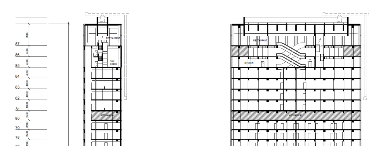

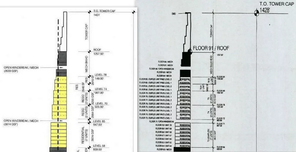

The plans actually show NO mechanical penthouse, just a few floors throughout the building labelled "mechanical":
This seems rather unlikely for a building of this height and slenderness. Where is the damper (or dampers) that would be needed to prevent sway, like in similar New York buildings?
Though 1200 Bay is not as tall as 111 W 57, it would still need more than what is shown. Even a conventional tower would need higher ceiling heights for mechanical floors housing boilers, cooling tower, elevator machine rooms, etc. What is disappointing is the implication that this is not intended as a real building, only a fantasy zoning exercise with a "star-chitect". Pity because it's quite a beautiful design.
Mechanical floors don't necessarily have to be located in the penthouse of the building, for example 81 Bay St is almost at ground level.
The water for the cooling towers would just be piped to the mechanical floor on a lower level, for boilers the exhaust could easily be ran in a mechanical shaft and vented at the roof. The 80th floor would be a realistic location for the mechanical room.

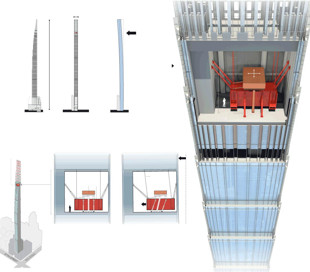

As for tuned mass dampers i'm not entirely sure as i am not a structural engineer, but i believe they could be located below the restaurant based on other buildings with dampers.
