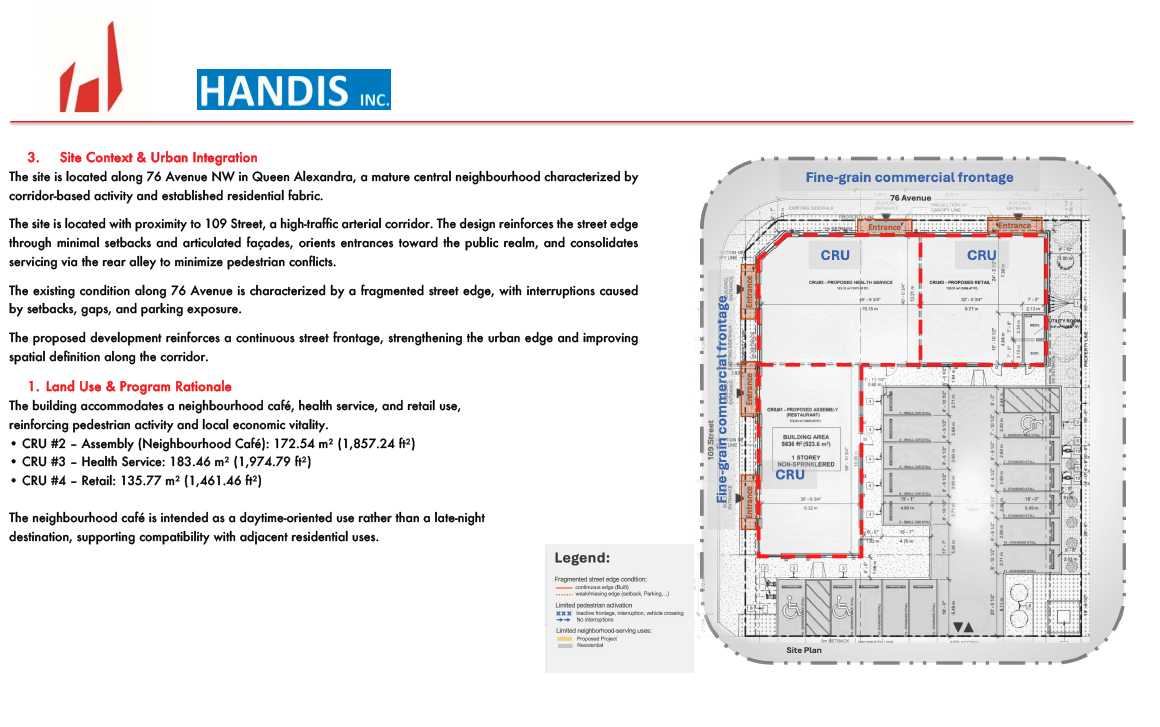

Consequences would include entrances mostly opening to the parking lot.
Which would of course unfortunately defeat the purpose of having the businesses right along the street where the front doors would be best for pedestrians. Very few businesses like to have two ways in and out of their businesses for customers.
Its almost like people could just... walk 30 steps from the parking lot around the building to the front :eek: Sounds so easy to me yet developers seem to disagree lol
For the life of me, I can't remember where it was, but I was at a building like this once (not in Edmonton) that had a hallway built down the middle that went from the back parking lot, through the building to the street side. It made it easy and quick to get from the parking lot to the front, and within the hallway space were public washrooms and maintenance closets. There were no entrances to the businesses from the parking lot side, just the single entrance that brought you out to the front.
No washrooms or maintenance closets but this is the setup for the businesses north of Jasper Ave between 112 & 113st. If there’s going to be a parking lot I think it’s a great design

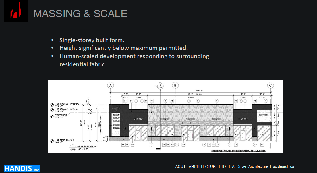

109 Street south of Whyte Ave is one of the few main roads in the central part of the city that has more residential than commercial along it.
So I suppose this development will fill a gap here and it looks nicer than the typical strip malls along our main roads.
However, I wish it it was not just one floor and had residential or offices above. That would be mixed use and would be better for the area.
