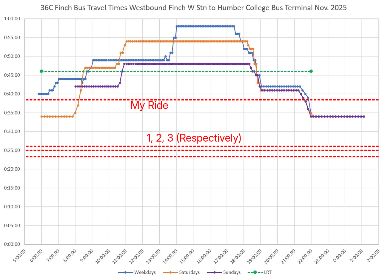

About that analysis.
I compared real case I had with 3 ideal cases.
1. No red light or red clipping (Slow for red but turns green before stop)
2. Same as 1, with no intersection speed restriction (Remove all slowdowns crossing green intersections)
3. Same as 2, with the untimely demise of Stevenson, Duncanwoods, and Driftwood.
THE HEADLINE:
- 39m18s minutes current, 15.9kmh
1. NO REDS: 31m6s, 20.1kmh (+26% speed from base-- This alone puts the 6 faster than the bus at all times)
2. + NO INTERSECTION RESTRICTIONS: 29m59s, 20.8kmh (+31% speed from base, +3% improvement)
3. + DEATH OF STEVENSON, DUNCANWOODS, DRIFTWOOD*: 27m44s, 22.5kmh (42% speed from base, 6% improvement)
Important caveats:
1. GPS on a phone can be a little rough sometimes.
2. I believe i was very conservative on the intersection restrictions and i underestimated the benefits of removing it. This policy not only affects crossing greens, but also crossing platforms parallel on the other track (!?) and slows vehicles down before the stop at all, which is very difficult to gauge and fix from GPS points. I would probably bump this up to maybe 6% improvement just by gut feefees.
3. Only 6% improvement from nuking stevenson, duncan and drift surprised me.
To add onto the great work and graph by Steve Munro,
Edit: My original post accidentally had this graph above centred at 25 min, not 30 min. Thank you to @urbanclient for pointing it out. Silly mistake on my part.
