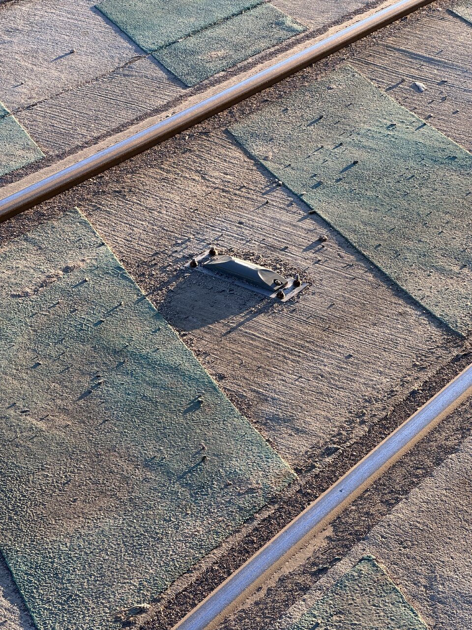

Not a scientifically empirically backed explanation but here are some pics of the rails between the Eglinton and Finch LRT. You can see the wheel-rail interface difference with the shine. These are taken at station stops.
Eglinton LRT:
Finch LRT:
The wheel profile on the Eglinton LRT seems to be very similar to the profile that the TTC uses for the subway.
Is there more wear on Eglinton where the trains are stopping? (which would be a downside of ATC).
I am very certain that ATC is supposed to result in less wear than manual operations, barring exceptions like Line 5 slamming on the magnetic track brakes due to intrusions and software bugs.
Wouldn't the breaking and acceleration be more specific to a certain very small piece of track, for each wheel? In a bigger picture, they certainly replace the streetcar track at stops more frequently, and I'd have guessed that it would only be more so if they stopped at exactly the same spot every time. Though perhaps the software varies the stopping location by a small amount each time - after 50 years of ATC operations I guess this isn't exactly cutting edge issues.
But I'm pulling it out of my ass ...
You're not totally wrong, as far as I know ATC is supposed make the acceleration and braking more predictable, and more gradual in Toronto's case (unfortunately?)
A human operator can put the pedal to the metal metaphorically like on Line 2. They may stay on the throttle too long, brake too late, too hard, leading to more use of the friction brakes relative to regen brakes, more wear for everything, more brake dust.
Good question, I’m not sure if there is more wear. Usually stations and stops have more wear in general.
The photos that I had taken was to try to show how the wheel profile contacts with the railhead. This effects the ride quality of vehicles.
